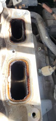

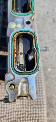

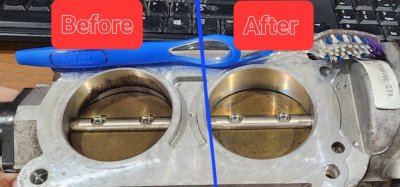

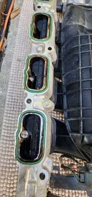

Oil in intake, TB, charge motion and in heads?

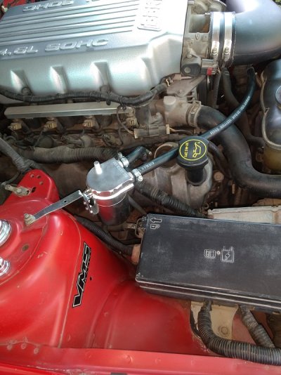

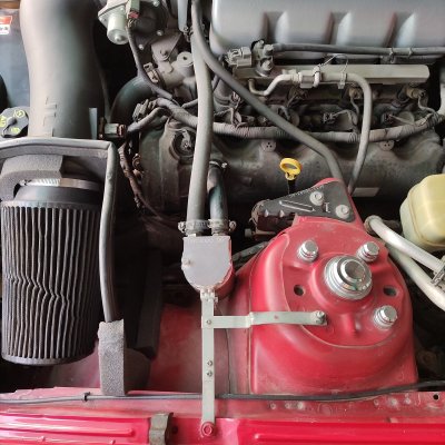

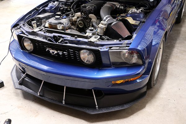

That looks normal if you don't have a catch can. i have a large moroso can and th oil vapor enters through the bottom, then has to go up a pipe and through some steel wool type material then back down and out to the intake. i don't get much oil in it and i don't get oil puddle in my supercharger intake behind the throttle body any more. imagine having a pool of oil collecting there and one day it gets sucked through a WOT. could be a very bad day. it's the aluminum bottle attach to the air filter shroud.
