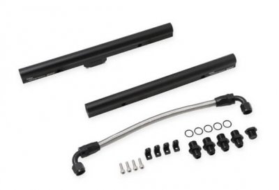

There are five attachments for the plumbing included in the box. I have the fuel cross over running in the back or can switch to the front. Where do the other pieces go? Theres one that's just to seal one of the rails off at one end. I've attached a pic of what's in the box. I know where the sensor connects but where does the actual fuel line connect...

you will need a fore innovations Fuel Line Adapter to connect the stock fuel rail. place plug on passenger side and run crossover around the rear of mainfold.

Actually that thing may work, it looks like 2 adapters connected
