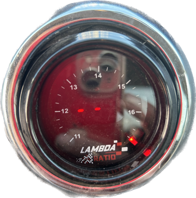

Does anyone know where the wideband goes on this kit? I would imagine in the down pipe bung but either the gauge is bad or that’s not the right spot it’s not reading correctly

That down pipe bung is where I put mine. Works just fine.

How is yours reading? How do you know it's not right?

Ok I just ordered a new aem one now Lito is tuning the car but we can’t proceed until the new sensor comes mine must be bad

5cd53a1e-6519-4eea-8e6d-2ad46c448091
It keeps going to this when I accelerate but off the log we did the front to o2 sensors show good fuel and load readings

The WOT had fuel in it as the front O2 sensors were reading quite high and load was high too and it showed - - - ...

Yeah, that would get my attention at wot.
I'll need to look at mine. No idea what I tied in to. I'll check tomorrow. I'm a bit impaired at the moment.
