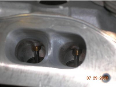

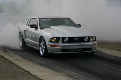

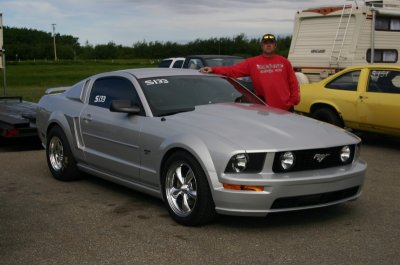

Well , all remaining parts were ordered today .The trip to JPCracing has been confirmed . Justin and Kevin Macdonald will tune on the 18th of April . We will test @Maryland international raceway on the 19 th .
new mod list
PT76hps Billet turbo ( 20-28 psi ) Tial V44 wastegate
turbowerx scavenge pump
JPC intake/gt 500 throttle body
33 spline spool/axle/moser 9'' ends with pro race rear brake kit
BMR tubular K member & extreme anti roll bar
Cage certification to 8.50
Kirkey pro street seats with covers & passenger side manualadj. seat bracket
The car is a 05 with a 322cui (Rich Groh Racing custom race motor )with 95lb injectors
JPC Racing TH 400 conversion with trans brake / tci 5500 rpm stall converter / MSD launch master / Eboost 2

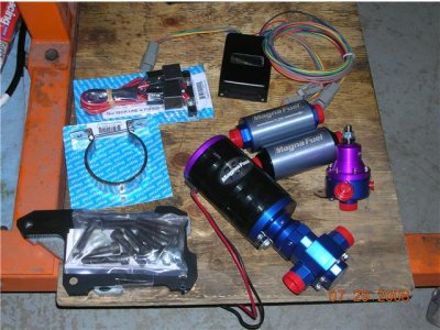

JPC racing magnafuel return fuel system
steeda Billet lca / steeda race uca
dspec adj. struts & shocks
Bogart rears with 28x11.5-15 et drag
jegs 15x4.5 fronts with MT sportsman rubber
As some of you know the car went 10.57 @ 140 plus mph on the break in tune with a turbonetics t76mm b.b. turbo ( very bad 60' / blew the tires off ) After planning extensively with Justin we all feel the car will be a low low 9sec monster . Oh by the way CK did I mention we are thinking of scrapping the liquid to air intercooler idea & going with a wilson pro flow nitrous kit . who knows , maybe a 300 shot just for you !:nana:( just gettin your attention ) lol:LMAO:
