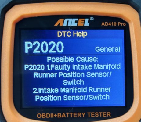

I drive a 2009 mustang gt with 126k miles and I’m getting the code P2020 and i haven’t been able to find any info on where it is located in the manifold and how to replace it. Ive been looking for a part number to replace it but cant seem to find one. Once i start the car there are no issues with idling or low rpms but once the car has reached normal operating temperatures it idles super rough but once the rpm’s are brought up it goes away until i stop again. I’m not sure if this could cause the rough idle or not. If anyone has more info on this code and or what i should do i would greatly appreciate it.

When the IMRC or Intake Manifold Runner Control goes bad, you replace the manifold assembly. I have a good used manifold available for 75.00 plus shipping

Ok thank you I'll look around locally and if i can't find one I'll lyk
