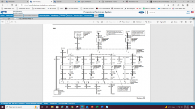

harness all looks fine for the o2 the harness was repaired due to the passenger tire rubbing and ripping the wires

Money rides on the fact that you have the wiring harnesses for the O2 sensors backwards (bank1 on sensor bank 2 and bank 2 on sensor bank 1) assuming the harness was properly repaired.
Common occurrence in 05-09 cars after header work or clutch/trans swap. Plenty of information on this and I have written an explanation as to what takes place when the harnesses get swapped...and yes they are long enough to reach either side.
Not a betting man but this is the first place I would look as mechs always seem to think its not important to mark wiring before disconnecting.
If you want to know why use the search feature.

harness plugged in correctly

I’m not familiar with that harness. But if the problem started after the repair, then the odds are that’s where the problem is. Can you inspect the repair and make sure wires are correct? There could be a short where bare wires are touching, or wires got crossed.

rhe problem been going on everysince i bought it 6months ago been at a buddys house ever since he coulfnt fix it so i brought it home the harness was properly fixed i dont think the harness is the issue
Can you be 100% sure of that?
Try switching the harnesses between the two front O2 sensors. At this point you have nothing to lose (except a few minutes of your time). If that fixes the problem, kick yourself on the butt for not thinking of it in the first place. ;)

yea tried this already :/
