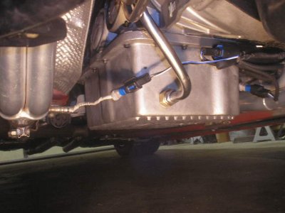

tom and the guys used my car for the prototype so i got one last year before they were released. i have had no problems. my car is lowered and there are no clearance issues even on speed bumps. mine is level with my L/T headers so if it ever hits so will my exhaust.
here's a couple of pics of mine. the quality is great as with all of PA's products and it makes servicing a breeze now. yes it is expensive as far as trans pans go but everything for these cars is pricey because so much r&d is required. i think it's worth it cause not only do you get the luxury of having a dipstick and a drain it also cools the fluid 25-30* and they are stable not varying more than 20* up or down even while racing in late rounds with no cool down time.
