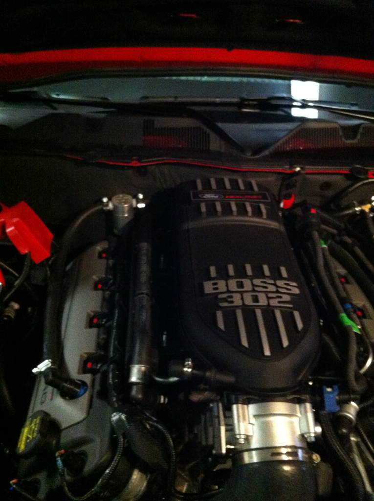

Old thread I know, But I just made the same thing
I need some one to explain to me how the pressure from both sides coming to one place is good. I did it because I have seen a lot of people do it. I would just like to know how it works.

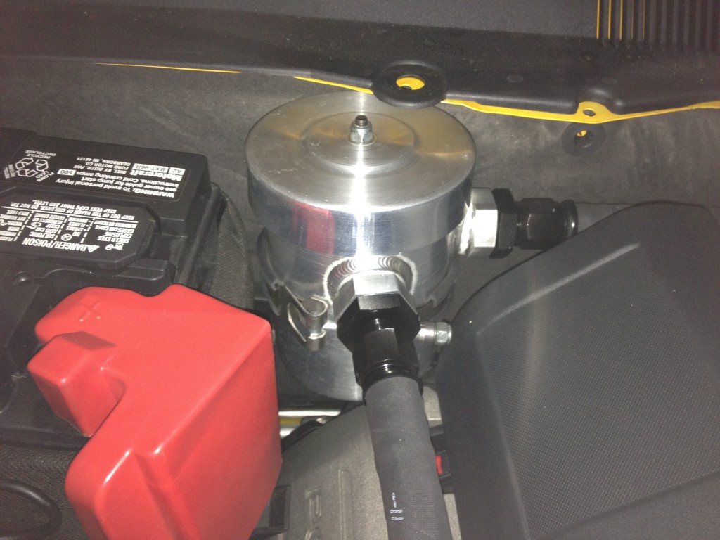

Here's a pic of the can I ended up with from Rehagen. It wasn't cheap, but it's a very high quality TIG welded can that can catch about half a quart. After a couple of track sessions, I dumped about a cup and a half of oil.

Lol I think he's got both lines running to his JLT catch can...which is unvented.
Maybe, but I see what looks like a T hose fitting in top right of SS KILR's pic. Hopefully that vents. Besides, it was SS KILR that made the point about needing to vent.

Your right I did have them both going to an unvented jlt. That's why I asked. I didn't think it would work. However I did just order this.
