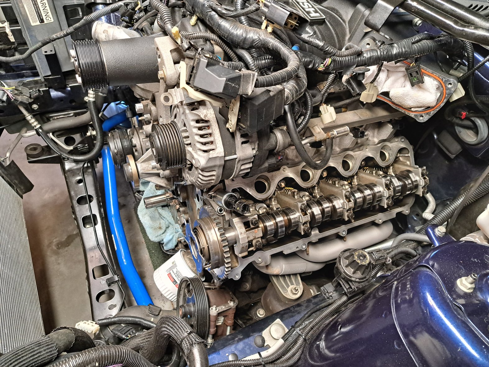

Thanks very much for the special tool link. Pic below shows where I'm at. I have clear access on both sides. Spark plugs came out easy.

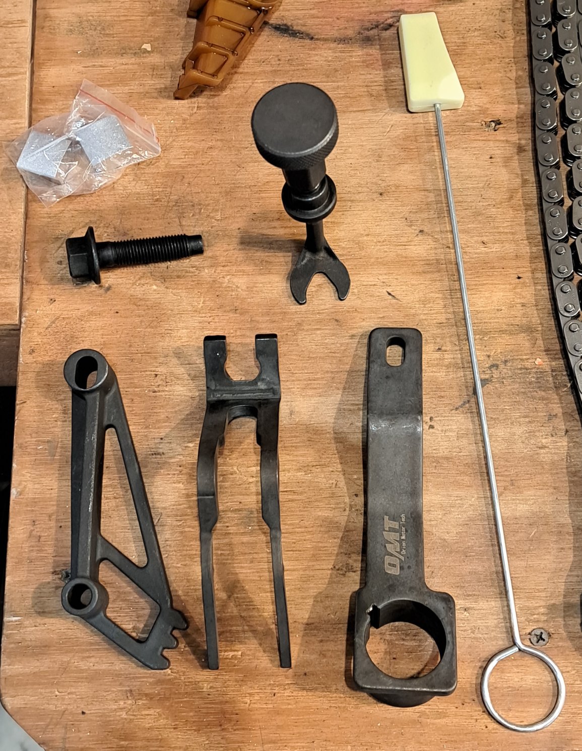

So I just got a box yesterday, which I ordered a few days ago. I opened it to see exactly what's inside, and PRESTO! It looks like I got the right tool. Plus my new kit has a few more parts, like a phaser lock, and some other things which I hope I never have to use, haha.

I can not stress enough just how difficult it is to reach the valve stem locks with the heads on the engine and in the car. I have changed the valve springs a couple times on my 3 valve. Only attempted in the vehicle once and was not successful. After dropping the locks three or four times I pulled the heads so I could reach the little boogers. Once you remove the cams and followers you should have no problem seeing the valve springs.

Lemme ask, do you think I'll be able to work with the spring compressor I bought (pic above), or should I just go buy one of those Ford compressors? If I have to spend a few hundred bucks more to make the job easier, then that's how I roll.
I plan on removing the cams to make the job easier, plus I want to check the rockers. I think the tool I bought is the wrong one for me. It looks like my new tool is made for removing valve springs with cams in place. Dang
