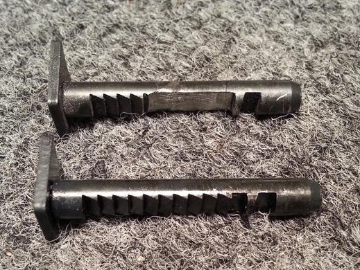

If you use the old style iron bodied tensioners that ratchet you should remove the plungers and grind or file the teeth off the shank. They still have spring tension and will pump up hydraulically but will not lock and over tension the timing chains.
Hey Bud, I am gonna use the iron tensioners. I finally looked at the old plastic tensioners, and right away I saw a bad gasket leak.
I've got all the valve work done, new valve seals, checked valve springs, new followers, lifters, cams back in, new timing chains on and timed, MMR chain guides.... now just put on the Melling iron tensioners. As you mentioned in your post, I want to eliminate the ratcheting..... Do you have any pics or anything that shows exactly how to do this?
EDIT: never mind, I finally found a pic, and a little video. All done, the last 4 ratchets are ground off and the Melling iron tensioners are torqued in place.
Thanks
