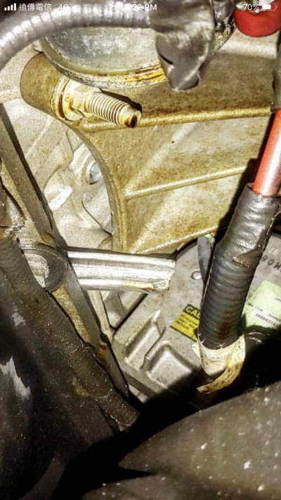

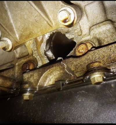

Don’t give her too much boost and she’ll be fine. My stock internals lasted a surprising 20k miles on 9lbs making 475whp. But when she went, she blew up good. Check out the rod hanging out of the block last pic, nice bend to it besides being snapped like a twig LOL

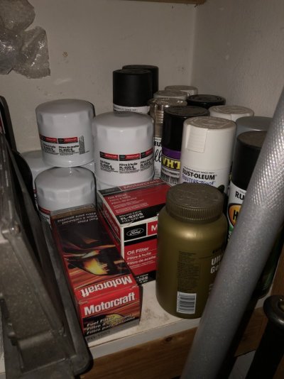

I get the 5qt jug of Mobile 1 for $20-25 with coupon. Since at one time I had three 4.6L Mustang GT's in the stable, I bought a case of the FL-820S.
