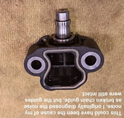

Done! The Melling tensioners are modified and installed...........
Thanks for the help gents!
Turns out my whole issue appears to have been a bad tensioner. I finally just looked at them and found this below. The guides were OK, but I installed new MMR guides anyway, just as a preventive measure.
I'll be replacing soon the exact same parts w\ the exact same MMR parts as you have.......except I'll be using all new ARP hardware on the MMR OE Ford 4.6L cast iron chain tensioners & oil pump itself as I fully intend to not be doing this job again after this.
After seeing 07Boss's situation w\ B1 chain tensioner bolt stress failures, I can't unsee\forget that image & my engine has over 176,000+ mileage on her so I know those bolts in my engine are heat stress cycled & potentially weakening...........too much work\potential damage to go thru IMHO vs the costs........that's just me I suppose.
Keep us in the know as to how all fares afterwards...................
