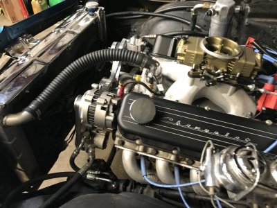

I'll upload my pictures and the info I've found on the 4R70W swap as soon as I get through this Chevelle build, I had to do my 4R swap in-between finalizing the EFI wiring in the Chevelle.
The driveshaft for the Chevelle came in today, roads were trash but we finally got to drive it. The new Holley EFI/trans controller is amazing, 600 Horsepower was never so easy.
