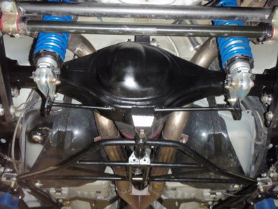

05mustang_TT_charged
Because Race Car!!
Nov 2, 2007
2,355
LSU Country
Speaking of rear suspensions, here is a pic I got from someone on MF a while ago. I think he is a member here now also. THEHARLEYDEALER this is underneath a 200? GT500
