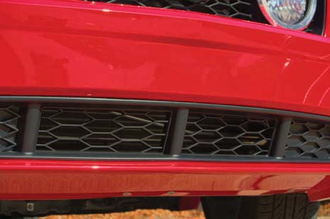

Man that angle is messing with my eyes something fierce. Doesn't look open at all, but I like those pieces.
