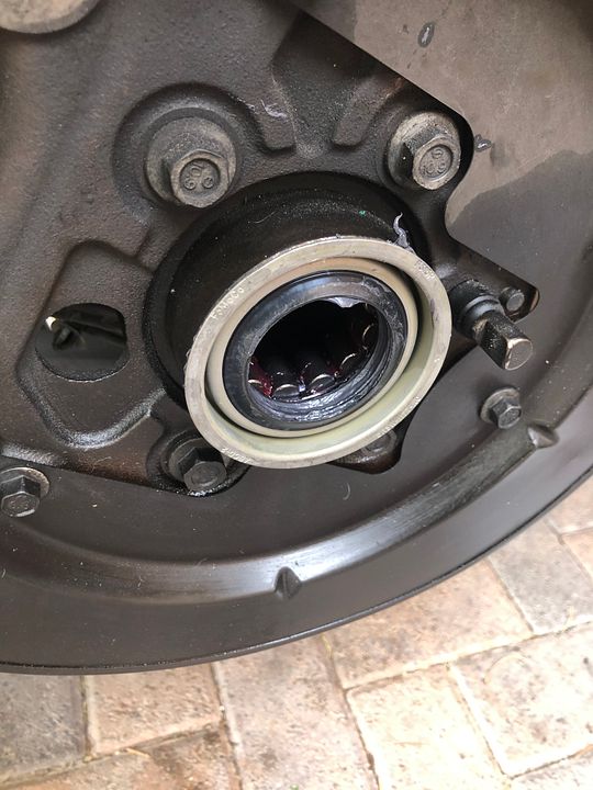

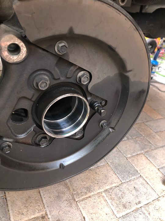

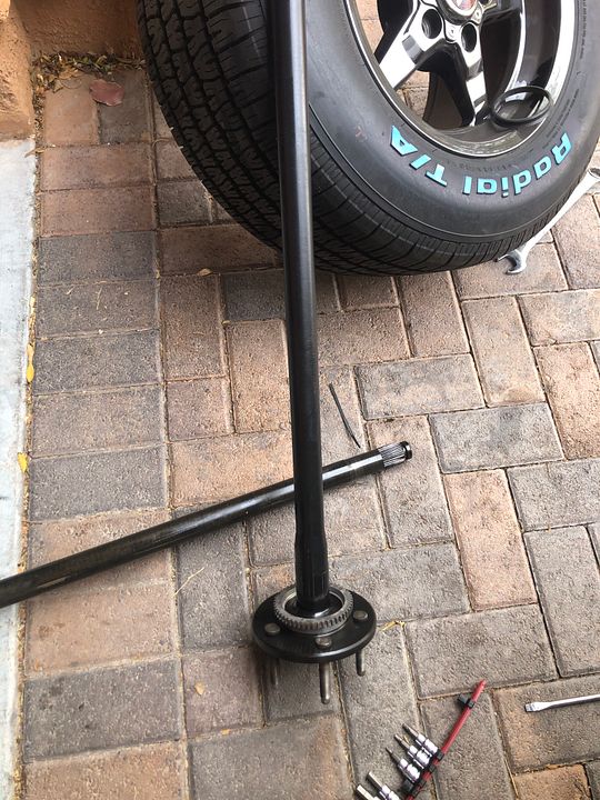

Not sure what you mean by hub assembly??? All you have back there is an axle, bearing and seal, and then the brakes. They are all separate components. Unless your looking for a whole rear end and differential?
This is when I had to R&R a bent axle.
Bearing and seal.
and axle.
What is it exactly that you are looking for?

Previous owner of the car for some reason has drilled out one of the wheel bolts and elongated the hole, only reason we can think of for doing so is they messed up the thread while attempting to remove a locking wheel nut and got carried away replacing it, so I guess the part circled in your photo?
JC SSP
Nov 8, 2022
2,283
1,353
FL
Then you require a new or junkyard axle. Very simple to swap out.
Also maybe a machine shop can weld and re-drill that hogged out hole?
