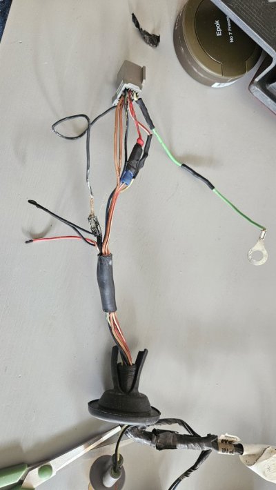

Hello all. I bought and imported a 07 gt, and the previous owner has sabotaged the harness trying to make it eu legal. Anyone have a pic of how these harnesses are supposed to look? The reverse lights are now blinkers(?)17452259406561117161327369229527.jpg

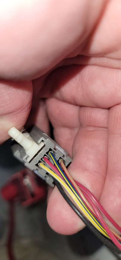

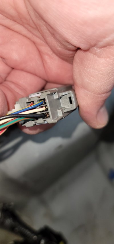

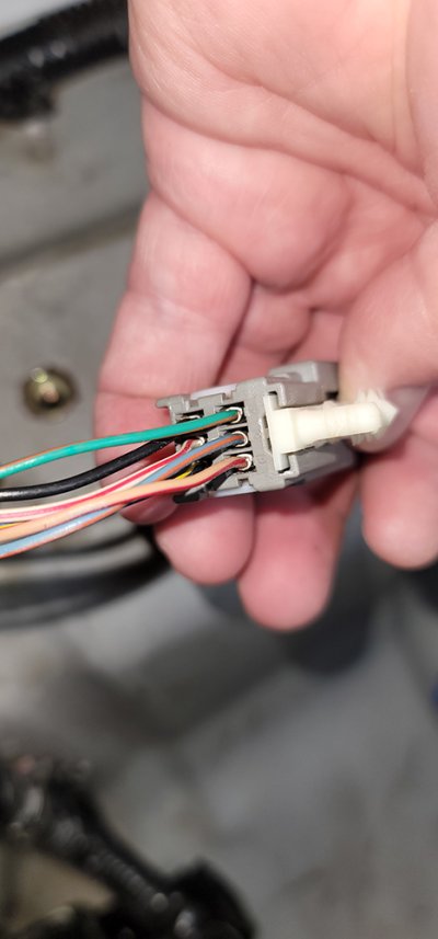

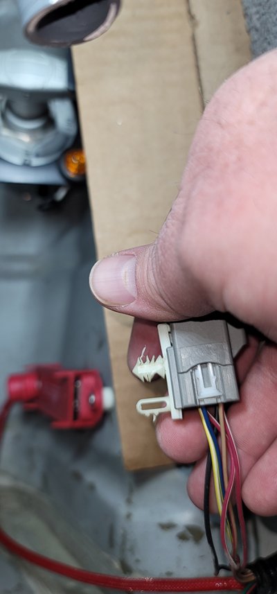

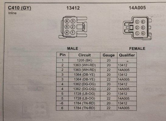

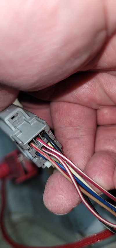

Unfortunately my tail light assemblies are packaged up and tucked away as I'm in the middle of rebuilding the car, so I can't easily get to them. However the rear body harness is currently still in place so I took some pics of the connectors. If the car still has the stock lights, then the wire colors should be similar. If not, you'll have to go by pin.
Firstly, there's no grounds from the connectors. The body harness is grounded, so that ground/ring I see is bogus. Not sure why they grounded the headlight harness.
The side markers don't connect in at all to the connector, so shouldn't be a part of it. If they tried to wire those in to make the side-markers blink, it would work but would probably throw a bad-lamp warning. Either way, they're not meant to blink and are separate.

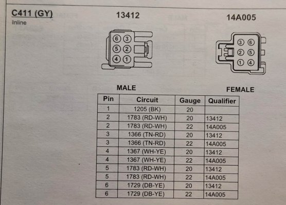

Here's the connector pin layouts (C410 is Drivers side, C411 is Passenger side):
