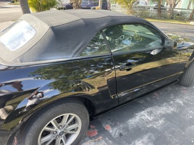

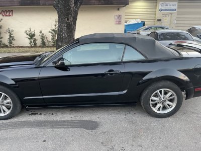

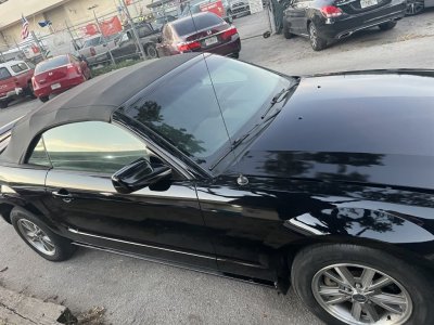

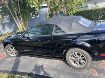

It's a small point and not sure what to call the parts. Looking at the new convertible top. I have a 2008 Deluxe convertible. Yours looks like an animal that's been starved and the ribs are showing. The ribs on mine don't stick out like that. Incorrect or cheap top?

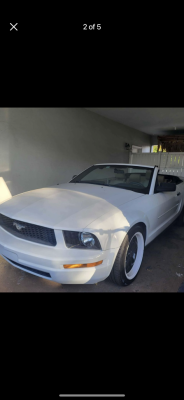

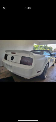

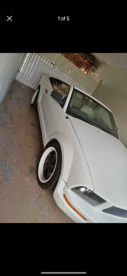

Alright. I got a new one for you guys. 2005 Ford Mustang V6 Convertible rebuilt title with 125k miles. I ran the vin and it’s been in 2 very minor accidents and a third that the insurance considered a total loss because of damage to the fender. The owner says everything works perfect and it’s been maintained well. The asking price is $4900 but I’m thinking of offering $3500 because of the accidents. What do you think?
tirefriar
Jul 12, 2019
31
14
So Cal

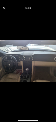

The gaps on the passenger front around the fender and bumper look off. In fact the right fender appears misaligned from looking at the last photo. Definitely inspect front inner structure (right apron, radiator support, etc.) for damages. The misalignment seen could be a sign of a structural dame to the right front no repaired properly not allowing the fender to align properly.
In most cases people who buy salvaged cars to repair and flip usually try to get away on the cheap. Proper repairs tend to eat up a significant portion of the profit and put their investment in close proximity of a similar clean title vehicle.
