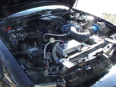

sevenleaf
Dec 30, 2007
444
You mean you don't want this to happen to you?
