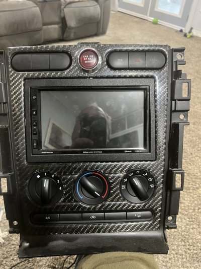

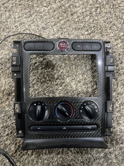

I’m thinking about ditching my Alpine radio and going with an android if I can get one that looks like this. I’m assuming this is an android in the first pic? What size? I’m wanting to add a tpms and obd2 Bluetooth readouts to my deck. Dunno if the Alpine 670 can do that thru apps. All the tpms I’m seeing say “works with android radio” but can it work on alpine with apps? What’s the biggest screen you can fit in a 2006 GT? Pics of me playing with sons old stereo

I’m sure someone with more knowledge will answer but it looks like a standard double DIN sized headunit with an adapter plate to make it fit the console. I used a similar, albeit way cheaper, setup in my car. Have a look on Crutchfield, their site is good at giving you everything you need for install on an application basis.

The first one looks like an Android head unit, check out Dynavin. I want to say they're 9 or 10 inches. They're expensive but they are a whole panel replacement to get the bigger screen than the 7 inch you get with a double DIN radio like that Alpine.
Doing the Android unit, you can do a Bluetooth OBD-II adapter with the Torque App installed on the unit. On the Alpine, you might need to use a separate module, made by iDatalink but everything I've read say it's not compatible with the 05-06 Mustangs (just my luck too)

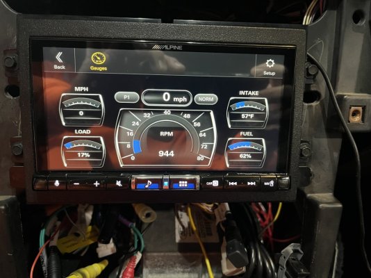

Update….the iDatalink did work on my 2006. Gauges feature does work. Still working on steering wheel controls.
Parts I’m using:
Alpine ilx-507
IDatalink Maestro RR
IDatalink Maestro HRN-RR-SA1

NICE. My Pioneer unit in the Tacoma can, and I can pull MPH in the mustang using my bluetooth OBDII adapter, so I'm pretty sure you can. You might just have to go through the menus and pick the right sensor/PID.
