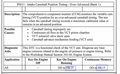

AbdullaGT500
Oct 26, 2010
4,482
Little Rock, AR
I've seen this several times on f-150's, usually when one of the chain guides break and chain loses tension.

Wait a minute, have I been messing with the wrong side of the engine this whole time? Is Bank 1 the passenger side? I'm confused, some places say P0011 is the Bank 1 cam(which I'm reading is passenger side) and some others say P0011 is the left cam...which is it? Maybe that's been my issue, I'm looking for a problem in the wrong freaking place.
hammeron
Apr 15, 2008
502
11
bank 1 is passenger side. it is also referred to as the Right side.
