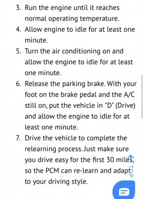

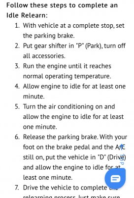

C0734F32-0FED-4A69-8805-0E537028A7F8.jpeg FC839D99-4382-436F-8B99-0ACA8E0154EA.jpeg A couple weeks ago I posted about rough idle on my 2006, V6 Conv. The thread was moved to a “regional” channel no one ever reads. Yet lots of S197 V6’rs experience. Well I have an update.
Ok, went through all the service records that came with my car… My car was taken to dealer for “everything” . Yes, I have the receipt for the tires from Worthington Ford, every bulb and windsheild wiper replacement… from Worthington -Insane, I know. But why I bought this car. Now, I read about doing an Idle Relearn??? for my problem. I went through both procedures I found online once my mechanic gave up. the first was disconnecting one of the leads to the battery, and grounding the other to reset… something = Zero Change. The second was this hokey process (refer to the attachments for correct order of operations) of turning the on, letting it idle to temp, then setting the parking break, then turing in the A/C then idling then driving it for 10 min… and it worked, it’s so calm now!!! I have driven it now 2 days and it has held steady. Some guys on another forum were pulling their motor mounts to solve this issue. -Wild.

The relearn process is very interesting, too!
