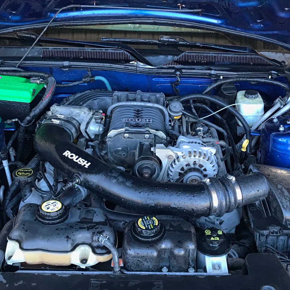

Hi guys I have a 2007 ROUSH Stage 3 with the m90 blower on it and I’m trying to find a strut tower brace that fits on top of the supercharger other than the $380 roush one. I heard maybe steeda makes one [emoji848] thanks

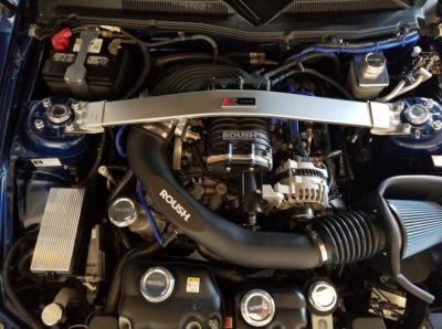

The plain Jane GT500 brace will clear the blower if you turn it around but it will hit your hood. There just isn't any room there. If you run a BMR K member that drops the engine mounts and if you run an aftermarket hood then you can find a couple that will clear both the blower and the hood. Every single person who owned one of these went through the exact same thing and almost everybody ended up not running a strut brace.

GT500 is what I did. The one I got barely touches the hood. I also push it down in the center while tightening the strut mount bolts to keep it a little lower.

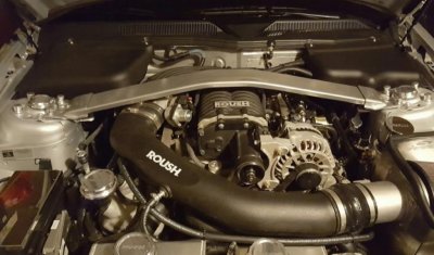

Boss 302 fits as well. I have my powder coated one for sale.
https://www.s197forum.com/threads/ford-boss-302-stb-black-05-14.135559/
Boss 302 STB will NOT clear the M90 blower. I had to remove the Boss 302 STB, after my M90 was installed. Sold it to a local friend, to use on his 2008 GT.
Interesting to note, that STB originally came out in 2010, for use on my 2010 GT. In 2011, it was used on the 2011 V6 cars, since they are a lot higher in the middle, vs the 2011 GT. It was re-used again in 2012/13 on the Boss 302 cars..where it was re-named the 'Boss 302 STB'.
It's a nice brace.... but unfortunately, it won't clear the Roush M90 blower, not even close.

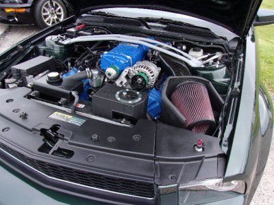

Odd you had issues, afaik it fits the 05-09 m90 cars, the fact that I saw it on a 08 bullitt m90 car locally years ago is why I originally bought one myself. My steeda dual bar stb I had before did not clear frpp or jpc. But the boss one did. Unfortunately doesnt fit my current custom intake so have to let it go. May get some spacers to try and fit it still, I have an aftermarket hood so do have some room to go up. I cant use a 4 bolt style as I have cc plates.
Quick search shows its a common choice for passenger inlet 05-09 m90 setups.

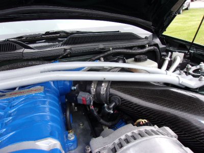

i modified my stock bullitt brace, ford racing with a bullitt tag, to clear a 2.3 tvs.
i have a BMR K member with drop mounts.

I have an M90 on my 07, I've tried many STBs including Steeda but the only one I found to fit was the GT500 brace. I agree it's not ideal with only 2 bolt holes per side but IMO better than nothing or messing with changing hood etc.
mrt2you, how did you modify your stock bullitt brace - I can't tell from the photos. I am planning to install a Whipple 2.9, and not sure the GT500 brace will fit on top of that.

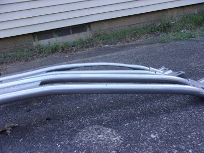

i modified the brace by bending up the rear bar about 3/4" where it goes over the throttle body.
i pie cut the top of the bar in about 8 places, bent it up them welded the pie cuts up.
i then cut the bar in 1/2 in the same area then welded in some flat stock in the hole i made in the bar.
after welding i ground the welds with 80 grit until smooth. after that i had it powder coated with a chrome then a satin clear, cost me $100.
if you look at the side view of the can you can easily see the mods to the bar where it goes over the throttle body.
NOTE: try to support the area where you bent it when you are welding it. if you don't the bar bend will walk back to straight if you don't.
also because i am using a GT500 hood and the strut bar indentation in the factory hood is more towards the front of the car than a GT hood i had to slightly bend the center of the rear bar down to clear the hood. if you look closely at the side view you can see the bend in the bar in the middle.
here are some pics of the bar next to a NOS one after powder coating.
in the first pics i posted the bar is in a aerosol bomb primer that was removed before powder coating.
