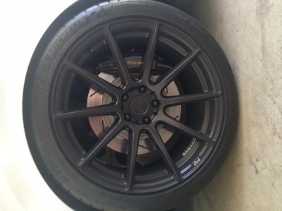

It's time to upgrade the pads on my 07 Saleen and I haven't had any luck when searching. I'm running the factory 14" Saleen front brakes (just comes with GT rears). I daily drive the car and occasionally do track events.
Any options or recommendations for us Saleen brake guys?

If they're the same kit I have, they're just re-badged Stoptech ST40 calipers. I use Hawk HB141x.650 pads (x = compound; i.e. G = DTC-60, U = DTC-70, etc.). There are plenty of other pads made by other manufacturers that will fit that caliper.
