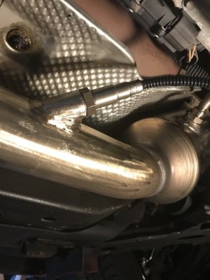

Here's my wideband sensor install. Driver's side. After the CAT. Been working great since initial installation (2 yrs now) without fail.

I always thought it wouldn't be a good idea after the cat, but then I thought of every dyno run on catted cars (that didn't already have factory widebands) where they stick it in the tailpipe. Maybe they have some algorithm in the dyno software that compensates for that?
