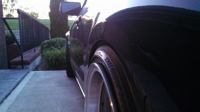

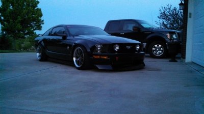

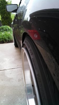

This is my version of slammed on
attachment.php
18s

lookin good, what have you installed to give you that drop?
would love some better lit pics for more detail

I'm running D2rs coilovers, no rear bump stops, 18x10 et+22 rear with 225/45s stretched, I'll have been pictures up soon, getting a photo shoot done in a few days

think those rims need some wider tires on em, not feeling the lip of it sticking out that much

The only reason I have 225s on 10s is because of the offset of my wheels and how low it is, a 245 will hit the quarter panel (already tried it)

any possibility of getting the rims in a different offset to allow regular tires?
these cars need more then a 225 on the rear

I used to have 18x10 in a et40 off set with 275/40s and it tucked into the fender barely

Yeah, it all just really depends on offset. I have 19x9.5 +35 with 285/35-19's and they stick out about 1/4". If my car sat any lower I'd hit the wheel well lip.
