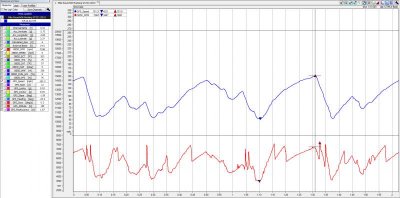

I went back and looked at some data and its about 7250 at 150ish with 3.55's and a 275/35/18 toyo rr in the back stretch at VIR. That is making about 425 SAE and 3600 pounds. Most stockish Coyotes will go about 143 back there. The way drive you may be a touch faster then that since you will be braking really late!
