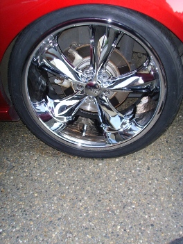

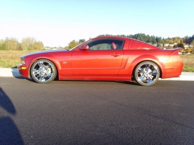

Here are my 20's with sportlines, no rubbing

jsawyer, newbreedgt05, gi joe, how wide are your front wheels? What size tire are you running? Thanks.

Ok, I'm running 275/35/20's up front, so I guess that's my problem. This sucks! Anyways, here are some more pics. (Keep in mind only the fronts are sportlines, the rears are still the Saleen springs)
