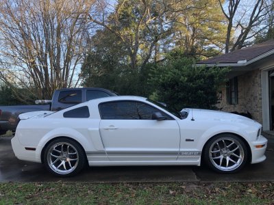

AM says the wheels will fit my 07. I’m running 20x9.5 40mm front and 20x11 50mm rear with no issues.
you can compare your current setup to a new setup pretty well by using this site.
https://www.willtheyfit.com/

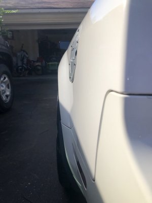

There’s several guys on here running 20x11 on the rear with similar offsets. My wheel comes right to the edge of the fender almost. I’m running 285 nitto’s on the rear now but will be going 295 or 305 next time as I was worried about the tires poking.
