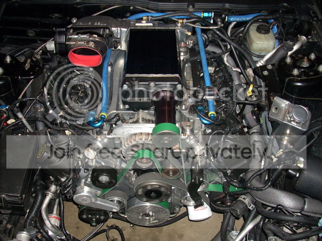

the green belt isn't sao bad by any means. I, personally, love it, and the fact that i never have to worry about it is nice as well. not the greatest pic in the world, but here it is
No the green doesn't wear off, at least it hasn't on mine yet.
The belts stretch fast and once stretched they will never get back to size again. by the time winter rolls around the damage is done. You can either replace the belt whenever the squeaks return, or bit he bullet and go green. tell people it saves gas and thats how you choose to go green, lol
What pulley is that just above the oil filter, Im using a Gates 38052 and have to press out the bearing a little, would ike to use a pulley I dont have to do that too. Car has been converted to an 8 rib. Thanks!

I'm using the same setup as in the pic, 122.3" belt with the KB.
The 2 idler pulleys on the driver side (above the filter) are 76mm flat idlers.
The belt routes a little differently than stock, i.e. it runs over that flat idler instead of underneath a ribbed idler.
76MM Thump_RRR pulley

Pic for reference to pulley I am asking about..
i answered you above since its my car 76mm smooth idler thumprrr pulley.
And if your gettign a squeak with the belt at cold startup or between shifts, you have a slight and i mean slight misalignment somewhere, about an 1/8 to a 1/16 misalignment. Most likely the power steering or supercharger pulley.
