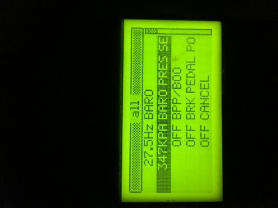

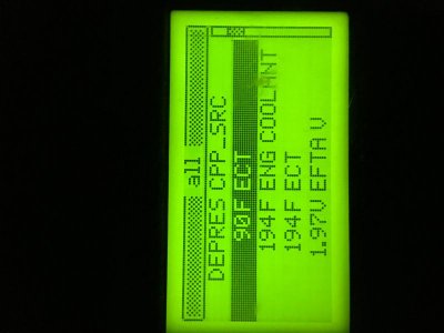

Everything stays operational, engine cranks but absolutely no hit of it trying to start unless I wait a minute. I ran my live data just a minute ago and 2 things I’m curious about, the baro pressure sensor and one of 2 ECT reading i have. As far as baro... I don’t know if it’s in range for Los Angeles California. And the ect, I have no idea but in the picture I have 2 ECT readings and one is correct and the other is at 90F degrees???

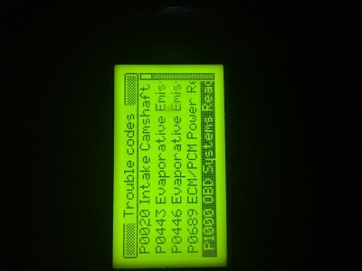

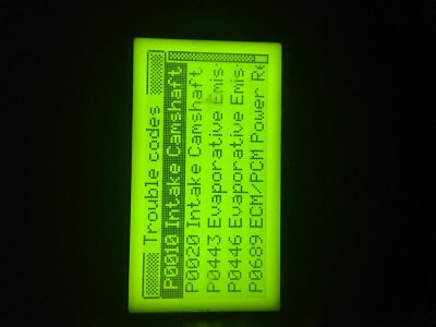

Well I think I found the culprit, I had failed to mention that everytime my car would randomly stall, I would get the same pcodes: p0010 p0020, 2 evap codes, readiness code, o2 sensors and p689. So I googled it yesterday and found a hit but not in a mustang forum... but in a f150 forum, well they experience the same issue except with one difference, they find a blown #32 fuse which ties all those sensors together. The reason that fuse blows is usually an o2 sensor wire melting against the exhaust manifold.... well went through my fuses and diagrams, and since my mustang doesn’t share the same fuse box as an f150, I do not have a fused link that all those components share... so what happens then, we’ll instead of a fuse blowing, I get a short and my ecm or pcm cuts ignition power to the engine for about a minute before it allows it to start up again.
So I looked under the hood at the drivers side o2 sensor and I could see the wire was awfully close to the exhaust manifold flange, so I reach down and pull it up and notice the sweet smell of burn wire insulation and also notice the plastic retainers that hold the o2 connector to the head wasn’t attached so I hang the wire on a clip that retains some
Ac line against the firewall. Happy to report this morning no stalling, I’ll report back any changes if it stalls again.
Cliff notes,
Stall with pcodes:
P0010
P0020
P0443
P0446
P0689
P1000
Equals melting o2 sensor wire on exhaust, causing short. (In my particular case)

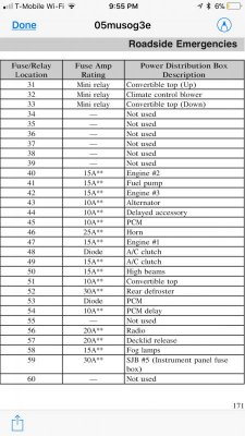

One of the diodes under the hood in the fuse box was intermittently failing. On my 05 GT, there are 2- 1.0 amp diodes and the tech was somehow able to test the diodes and discovered one of the 2 diodes had been failing intermittently, the service writers exact words were “the tech tested the diode and found out sometimes it’s working and then it stop, the working again, so he replace it with a new one and your car stopped stalling, he drove the car a lot to make sure that was it, he let it idle for along time too and no more stalling”... so I picked her up, paid $144 for the service and I’ve been driving here everywhere since Thursday and no more stalling. Yay! Hopefully this post will one day help someone and save them a lot of headache by knowing a simple 1.0 amp diode cause so much grief and could be replaced by anyone for probably less than $10 and 1 minute of spare time.

What diodes ? What are they used for exactly? Are they steering diodes, so the signal doesn't back feed onto something else? A 1.0A diode cost dick. 3A and 6A diodes have surge ratings of 200/400 A respectively..and are bomb proof. Your typ 1.0A diode has a surge rating of 20-30A. I buy all 3 types by the hundreds for other applications..and those are all 1 kv PIV types. You can also series em for nore piv..and you can also parallel em for more current.... ( and also more surge current).
CJ-
Dec 23, 2015
190
from California
Well in the manual slot 53 is a diode for the PCM which I’m assuming is the one that was replaced, the other diode is slot 48 which is listed as A/C Clutch.
