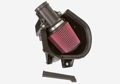

I just checked the Roush website now and I, therefore, stand corrected. It appears that Roush, after all, does manufacture their own intake designed for 2010-14 models. Anyhow my mistake!

Here you go
http://www.roushperformance.com/parts/Mustang-Cold-Air-Intake-Kit-2010-2012.html
Not the one u posted pic of clearly
Now can you understand where this shit was confusing for me on an oddball year with oddball parts and being my first mustang and first tune???? Damn
Yeah, I understand now regarding the intake, as I was clearly wrong. However, IMO you could still use the stock tune file from your SCT X-4 for the Roush CAI with no problem.
Although it will work with a 2010, it still retains the same..'snorkel' that goes from new airbox..to the front grille. The 'snorkel' is the main restriction, it's mounted vertical at extreme right side ( driver's side) of upper grille. It's not very wide, and not very tall. If you want more airflow through the oem 2010 airbox, all that's required is a K+N panel filter. With the K+N installed, you can hear the air scream through.
The Roush 2010-2014 CAI, when used on the 2010, re-uses the same MAF sensor, so ends up being a NO-tune CAI. IE: it's oem stock for all intensive purposes. The 2010 TB is a twin 55mm affair. The 11-14 cars use a single 80mm TB.
The roush cai is a NO tune device. No reason why steeda can't tune for it. All roush has done is replaced the oem airbox with the new box + cone filter. Everything before and after the new cai is bone stock. It still remains a no tune cai per roush. So steeda has it wrong, it's stock for tuning purposes. On a 2010, the roush cai is a looks only device, comparable to the oem box and a K+N filter.
That roush cai won't work with FI, and neither will your new JLT. And neither are required on any NA setup.

What I don't quite understand is how this non-tuned Roush CAI works for both the 2010 4.6L 3v and 2011-14 Coyote 5.0 4v. You would think it wouldn't work for both, due to having different sized throttle bodies, with the 4.6 3v having the 55mm twin TB and the 5.0 Coyote with single 80mm TB? But then again, I'm more familiar with the 2005-10 4.6 3v cars, to begin with. I also agree and see no reason why Steeda couldn't just write up a base tune file for the OP to download into his SCT X-4 via e-mail if necessary. However, I also see no reason why the OP couldn't just select the stock tune file from the X-4 being as his non-tuned Roush CAI has the same MAF housing as OEM stock anyhow. Therefore Steeda most definitely has it all wrong just as you mentioned.
Below is from roush..under 'description'.
"This CAI system has been engineered and tested to ensure that the MAF signal performance (including airflow vs. voltage and signal noise) is TRANSPARENT to factory settings, which is why our kit does NOT require a unique calibration." "New premium MAF tube included"
The tb upstream does not enter into the equation..since the re-used MAF sensor is downstream.
On the 2010 the cai is the same size as the 11+. Roush supplies a new MAF tube that fits their new air box. Other end of same new Roush short MAF tube fits into oem ford cai rubber tube..then off to the TB. " Note: Does NOT include new clean air tube (reuses factory) "
The 2010 also gets the..'sound tube' that pipes air induction noise into the cabin..same as the 11-14 cars.
The oem maf sensor is re-used. MAF = mass air flow. Which is the weight of the air..and not the volume of the air. At higher elevations, you require more CFM to achieve the same mass airflow . That's why they measure mass airflow..and not cfm.
The same concept also applies to cooling applications when at an elevated site. In denver, you require 20% more cfm..and also 20% more pressure.... vs sea level.
This new roush cai has the same MAF voltage as the oem airbox on a 10-14 car... no special tune required. Since its all bottle necked at the MAF sensor, any perceived performance gains are cuz of the lower pressure drop of the new cone filter vs oem paper air filter. But the oem 2010 airbox flows 800 cfm with oem paper filter..and 960 cfm with a K+N filter....so the roush filter is no better than the oem airbox and K+N panel filter.
Nothing fancy required on a NA 2010 3v. The roush cai is an aesthetics device, impresses folks at car shows....and no tune required. Any additional HP will obtained from the new tune, the cai doesn't enter into the equation on a 2010 3v NA.

My mistake as your right about the TB not entering the equation since the MAF sensor/housing is downstream. I also didn't realize the CAI on the 2010 4.6 3v and 11+ Coyote 5.0 are both the same size, as I assumed the MAF housing for the 11+ cars were larger in diameter. Therefore once again, I stand corrected. Anyhow I also attempted to recommend to the OP to consider purchasing an "OEM" stock airbox for his "2010" by doing a google search for OEM take off parts, being as very little would be gained if at all by running an aftermarket non-tuned CAI on a N/A 4.6 3v over the "2010" stock airbox. In the meantime, thanks again for bringing me up to speed :waytogo:
