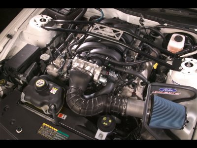

Thanks for the lead on Tasca. I wrote them and I'm waiting on an answer. Let me ask this. I have a ford racing CAI off a 07 shelby gt. I bought it off craigslist. The guy I got it from said I wouldn't need a tune to run it. I installed it and the car wouldn't run with it on. So I removed it and its been on the shelf in the garage since. Should I save $200 and just bolt that cai on, or should I stay with the jlt? I want to do the upgrades right, but If I'm not gonna notice the difference between the 2 cai, it be great to save the $200. Also I can't seem to find the option to by a jlt2?? Only the 3 series. I posted a pic of the cai I have. If I can save the $200, then I'd be below my $1000 budget.
Save the $200, any difference between the two will be negligible.
Save the $, all the work is in the tune anyway. A guesstimate would be maybe a 5rwhp difference between the two. Focus and consider what octane you would like to run for the tune, i went with a single tune file for 92 and fill up with 93 for a little safety net. The jlt2 would be a good pickup used, not new if you still consider that.
Gl on the budget and hope you get everything done right the first time.
