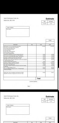

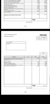

it's not just a swap, new motor, swapping over all accessories, new cams & gears, new dampner, new head bolts, new oil pump,
jdlatil
Twin Srew Driver
Sep 16, 2007
75
If you can’t to the work your self be prepared to pay a fair price.
If I didn’t do all my own work, I would not be able to drive fast car.
I’m sure they would do good job. Turn key cost big bucks!
eighty6gt
May 9, 2011
4,306
416
gee whiz that's a nice quote they did for you, that's not free for them to do. Even if you don't end up going with them, drop some beers by sometime.
