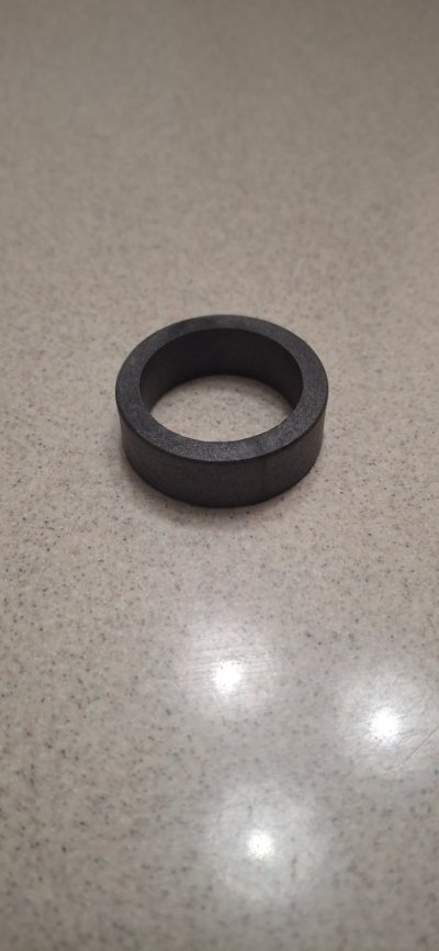

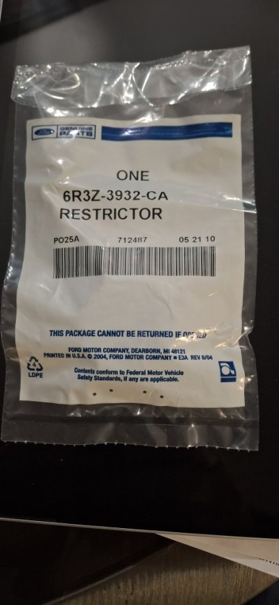

Having issues with the limiters, ordered from the dealer as link provided only had quantity one.

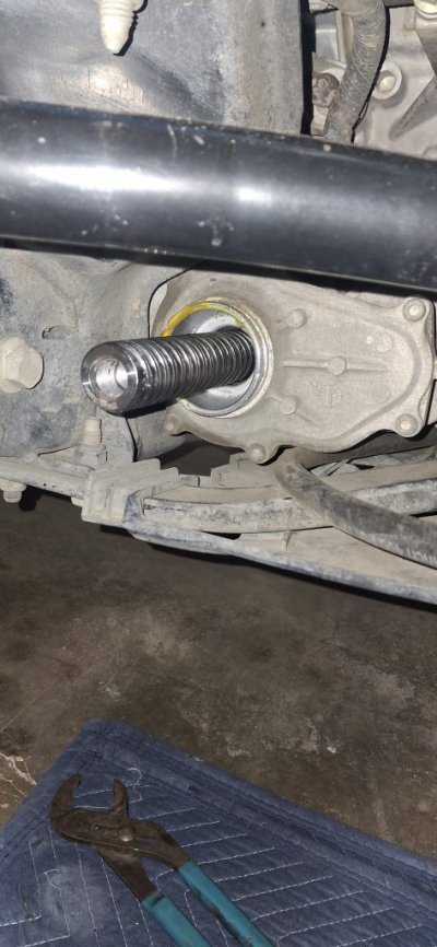

I got the inner off and started on the right side of the car. Photo below
The restrictor is too small to go over the output shaft of the EPAS box. Looking for guidance from anybody.
View attachment 113613View attachment 113614
Is it rubber? Can you stretch it over the shaft? does the outside diameter fit in the hole in the box? If so it is meant to go in there I would imagine. I have never installed one. You will only restrict the wheel one direction with one.
Edit:After some research it appears that EPAS boxes do not use that OEM restrictor and they are for the old style hydraulic racks. Believe it or not there are different Ford part #s for 17" racks and 18" racks so the restrictors are built into them. It is possible that the aftermarket C shaped restrictors will work but I would check with seller first. It seems ridiculous to need a whole new rack to change wheel size or put up with rubbing your wheels when you turn too far.
Where did you find that information? I slept on the issue and believed it is an interference fit, so plan is today to measure and find a way to install them.
What part numbers did you find for both racks?
Please let me know so I can get this worked out before the new wheels come back from refinishing.
You can give it a try since you have one but if I were you I would order these. You don't need to take apart the inner rod ends since they just snap on AND you can do both left and right sides. Plus you can "tune" the amount of restriction to the amount you need to stop the rubbing.
https://slrspeed.com/products/s197-...ovK_OnLkTsh-XCznozCkX6SJXnwTOdD4fcB4NDP4di6Kp
*Someone just posted a guide to installing the Ford restrictor on our cars. You are right it is a tight fit. You need to force it on using a nut and bolt.
https://www.s197forum.com/threads/i...ing-rack-restrictor-2013.154390/#post-2589387
That was me. Job is done.
