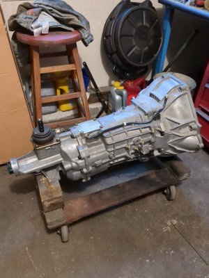

Stumbled into a take out t56 from an '03 cobra (has Bell housing too)IMG_20221106_161204_01.jpg ....anybody still make parts for this conversion? A search just gave me old info and all the sources seem to be out of business - should I just sell it to an sn95 guy or is it worth swapping?

I'm currently planning a T56 Magnum XL swap for my '14. Lethal Performance has a kit, but they also outline everything you need....
Kit Includes:
  • Tremec Magnum XL Transmission
  • FMC-BR3Z-7A508-B Slave Cylinder for 11-14 GT -OR-
  • FMC-4R3Z-7A508-AA Slave Cylinder for 05-11 GT
  • DSS-FDSH9-A-MAG2 Driveshaft - Aluminum with Billet Yoke -OR-
  • DSS-FDSH9-C-MAG2 Driveshaft - Carbon Fiber with Billet Yoke
  • BT-T56HARNESS-T56-RLM Conversion Wire Harness
  • ARP-156-2801 Flywheel Bolts
  • M-7600-C Pilot Bearing
  • MCL-139251 Clutch Line
Clutch Options:
MCL-6932-07 + 463458 (RXT 26 Spline with Lightened Steel Flywheel)
MCL-6932-07HD + 463458 (RXT HD 26 Spline with Lightened Steel Flywheel)
