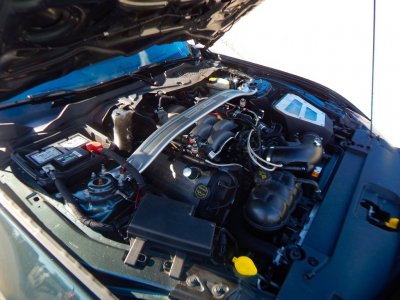

Hey everyone, I previously had a 2014 Coyote 5.0, but I now have a 2016 Coyote 5.0 and would like to know if the #10 slot on the 70 pin PCM also applies to the 15-17 Gen. 2 Coyote platform?
I made the mistake of buying an Intellitronix Window switch for my Nitrous setup which requires either a direct connection to the tach output on the PCM, or a tach adapter. Thanks everyone DSCN3833_edited.jpg DSCN3820_edited.jpg
