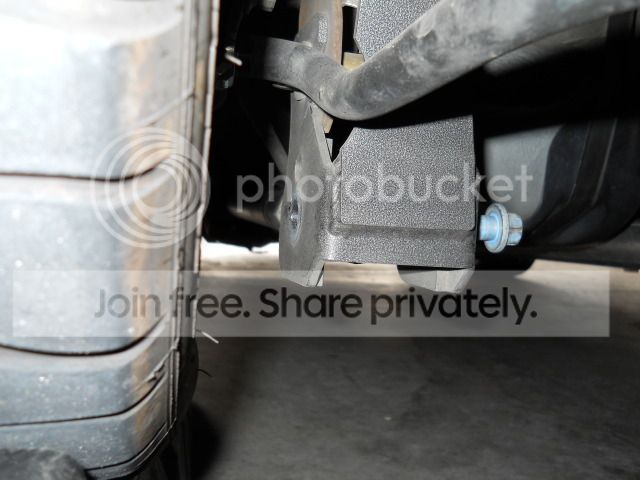

so driving back from denver just now my car started jerking side to side whenever i would either let off the gas or push it while coasting. luckily i made it back home safely and found this.....
the last time they were off was 3 1/2 years ago when i added the relocation brackets. how the hell does that happen. and yes there was locktite on it.

That's a factory bolt that's in there which is a one time use only. Looks like you re-used it.
yes as do many other people. what gets me is why after over 3 years would it back off.

^^I did. These are critical bolts and they are the one time use torque to yield type. If you reuse them it's like playing Russian Roulette. You may never have a problem or they could let you down just when you least want it to happen. The bolts aren't that expensive so either replace them with grade 8 or higher, or buy new Ford bolts.

hmm... the BMR's I just installed on a friends car had new bolts and nuts with them. Maybe they started doing that since you bought yours?

That is odd as hell.......My BMRs came with all new bolts too

Whats different about torque to yield bolt than regular grade 8 bolts? The aging process??
They're designed to stretch when torqued the first time to increase clamping force (better seat/fit against all threads) but they don't unstretch when you remove them, which is why you replace them..
My relocation brackets came with bolts, too..

Looks like UMI's design won't ever have that type of problem since you retain the factory flag nut. The bolt it comes with for securing the rear of the arm is AFAIK not TTY.
