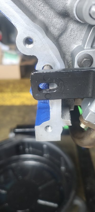

Hi all, just wanted to double check things before I put the cover on the timing gear. I am probably overthinking things but I noticed the 6 o'clock rule for the bottom cog is defo at 6 o clock but the timing tool just doesn't sit in the dowel. It's about a tooth out ATM. Which should I go by or can I trust a tool?

How does your L chain look on the crank gear? The pictures you’ve shown, look fine.
I’m not sure I understand the point in that tool. It goes on the crankshaft?
I’ve never used any special tools to time modular engines. 2, 3, 4v, or coyote, nothing special needed.

What is this timing tool you speak of? I've done mine 3-4 times and don't know what we are speaking of.

The both black links are on the dot on the bottom cog Warrior. Thanks for the advice. one thing I nearly got wrong was the tensioner guides. Very little difference on them except on the left the chain can run on the edge of the tensioner if its the wrong one with the shoulder.

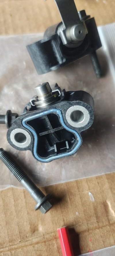

I bought the Ford performance timing kit on recommendations of Dino. it is a costly set to purchase. I know how critical it was to have quality timing gear as there was a lot of talk online about cheaper timing chains breaking or stretching. I am however a bit disappointed in the tensioner seals? Just a shitty bead of silicone around the frame that is actually loose in a couple of places. I know from reading online that tensioners can have gasket blowouts? which let tension off the chain. I'm worried about these tensioners not having a proper gasket or is this the norm?
