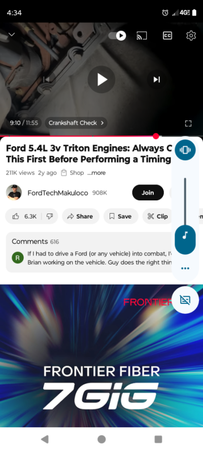

Fordmikiloku tech on YouTube has a video showing how to check for the endplay and if it's too much the block is no good ..
At least if memory serves me correctly...
If u look him up and the video and see what's going on
If the play is too much it chews into the block or something else that ruins the block

Thanks, i've watched that video. When you push to the crankshaft pulley with a pry bar to push it back inside the block and then push the clutch pedal all the way down you can clearly see that the pulley is coming forward. In the same time you can hear how the crankshaft is touching insides of the block. So i'm already prepared for the worst. I can buy a used short block with 12k miles on it for $1500, or a long block with 60k miles on it for $2500. But i'd rather spend that money on my engine.

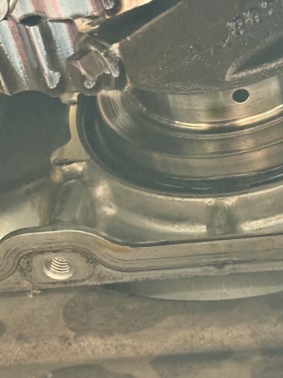

So today i went to the shop and the mechanic pulled off the pan. Number five main bearing is scored like i expected. Crankshaft is also scored pretty bad where it contacts with the thrust bearing. Other than that everything seems to be fine. The block itself isn't damaged. So i need a new crankshaft, or a set of oversized thrust bearings and washers, but i can't understand if they are available for these engines. New crankshaft is on backorder, and Eagle cast crankshaft with stock stroke will require eight-bolt flywheel. So i'm little confused. I even thought about buying a stroker kit, but it seems like it's not worth the money if i'm not planning to supercharge it in the nearest future. I would appreciate any advices, thanks.
You might be lucky enough to find a good used crankshaft from a breakers yard in neighbouring Poland or Lithuania if they have any 05-10 Mustangs in stock. Our German friends here might also be able to help out.
