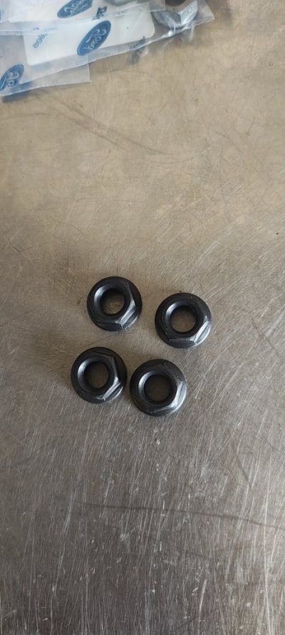

MR.GASKET 6717 TORQUE CONVERTER NUTS FORD (6717) Are these compatible with a 4.6 three valve 5r55S transmission? I bought a set back a month ago and went to fit them today and they are a thou smaller internally measuring on the Vernier callipers. They will start on the threads but are defo feel too tight to turn. The old nuts run up by hand on the same convertor stud. Any info I see online confirms they are correct? or are they meant to be really tight to run up the threads? the new nuts have flanges where the old nuts dont if that helps answer my question?

Thanks Brasil, I thought about that as the old nuts look soft and slightly deformed but hard not knowing anything about the type of nuts they are supposed to be. I will take a second look at them to see if I spot what you're explaining. I was very concerned about stripping threads as I foolishly didn't try them on the studs before putting the transmission in. From my mechanical experience they feel way too tight even for self secure nuts as I have used them before. I spotted another set without flanges that look more like mine from Ford so I ordered them today. I have no idea if they are going to be a better fit as there's no spec on them apart from a part number. There's only two options out there that I've found so some of the two hopefully has to fit.

The other set of Ford convertor nuts arrived this morning and I am a lot happier about the fit, they only start to lock as the stud passes through the top of the nut. I know for sure now Mr Gasket nuts are are a different thread or pitch. The ford nuts contain no info about thread size pitch etc.
you will see Flanged info on the Chinese nuts on the back of the pack but it makes no relevance to me?

I measured out the new sets of nut and the Ford nuts were a thou bigger in I'd than the Chinese nuts also the Chinese nuts were 14mm socket size compared to the Ford nuts that were 15mm socket size. I see no difference in the thread size or pitch comparing the two.
