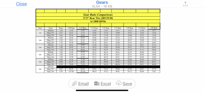

Hopefully this works. Keep in mind, the speeds shown are based on my rear tire size, so your results might vary some. I used the calculator on Tremec's site for this. So, if your tire size is different, it would just require you taking the time to go to the site, input the correct data, and start comparing.

It posts, but clicking the image to enlarge it isn't working.
If you don't mind, may I suggest a couple of things?
Round the speeds off to whole mph (as numbers, no decimal places).
If you're computing based on the tire size or its advertised diameter, include a downward 3.5% correction (100 mph calculated becoming about 96.5 after correction but before rounding). This accounts for tire tread compliance effects and usually matches up very closely with tire revs/mile given by the tire mfr.

Well, I got what I got . . . no going back now on the trans/rear gear combo, LOL.
But, rounding up on the spreadsheet is an easy lift. But, rounding down 3.5" on the tire would mean going back and using the calculator on Tremec's website again for each combo.

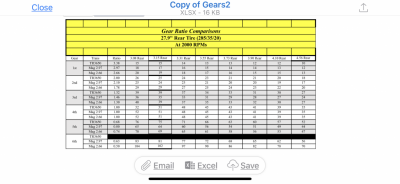

Not necessarily.
Make a new chart that multiplies every mph in your existing chart by 0.965, copies the non-numeric stuff directly, and only publish the factored table. Maybe put it on a separate sheet and label the sheets, or add to the label in the table heading so you know which chart you're looking at.

Okay, if it helps anyone, here is the same sheet with all values multiplied by .965 and rounded to the nearest whole MPH.
