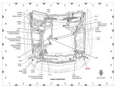

I did a search on this forum and really didn't come up with much, searched on google and found the fix.
This happened to me yesterday while driving. Both dash lights turned on. Apparently this is common, my ground was corroded. Took some sandpaper to it and put some dielectric grease. Lights turned off immediately. Here's the diagram for it (affected one highlighted in red), just thought i would throw this up on here in case anyone else ran into the same problem.

Yeap I accidently grounded a wire I shouldnt have in the trunk one time and it did the same thing have to trace over my work and found the problem and the lights went away.
