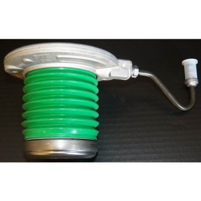

Is most likely Tob mine did the same thing finally it started leaking then you will be calling the tow truck.
