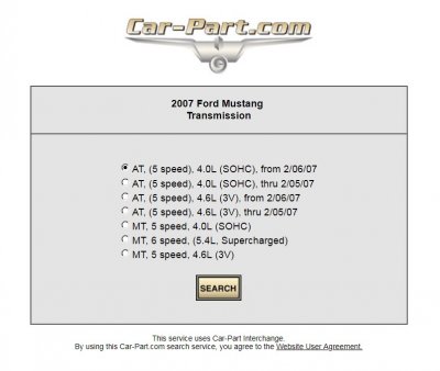

I really need to find out if there are differences in the auto transmissions between year 05,06 and 07 on to 2010. Here's an example of what I'm finding that's leading me to inquire about this. On rockauto's website, for a re manufactured 5r55s for years 05 and 06, the part number is T163021. However, for years 07 and on to 2010, the part number is T163026. Both of these Tranny's are from the same re manufacturer, and are priced the same too, but they have a different part number. So this leads me to ask, is there a difference between the 05, 06 and 07 on 4.0? Mainly, the reason I'm looking to clarify this is because a lot of these tranny's can be found online, and I want to avoid buying one, only to find a single bolt difference now means I can't use it.
CtCarl
Affiliate Member
Aug 3, 2017
10
Southern Connecticut
FWIW, Ben, I usually go by car-part.com's interchange system for stuff like this.
The bottom line seems to be that up to 2-5-07 is one part, and 2-6-07 and after is another. I'd suggest going by the build date on your car and matching it up with the appropriate date range.
Luckily, the breakpoint of February 07 means that there are plenty of donor cars on both sides, so if you're looking for a used piece, you should have lots to choose from.
Hope this helps!
