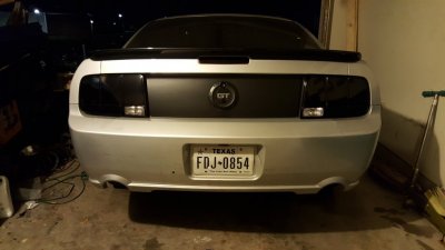

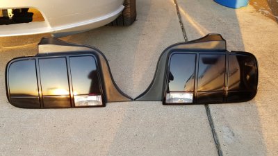

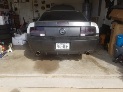

I did this swap due to the awesome look of the 05-09 body with its sleek (almost foxbody) semi squarish rear end. I didn't want to fill holes, nor do I care enough about paint to justify the cost, so I ended up finding a non spoiler trunk lid and negotiated down to $60. I then removed the lock, badge, wiring and everything and used $5 of black matte plastidip to cover the gloss black that doesn't match my bargain $100 platidipped rear bumper or factory satin silver stang. Put all my factory trunk lid parts and lock in the "new" one and was back in business. Pics show sort of a time lapse in between "painting" parts. I did however take the proper time to prep and smoke the taillights to my liking. Without the dust the plastidip doesn't look bad IMO. I'm just a cheap a$$.

The cheap trunk did have to be tweaked a bit to get it aligned close enough due to a rear impact on the "doner" car that wasnt originally noticeable. So maybe I got what I played for. lol
