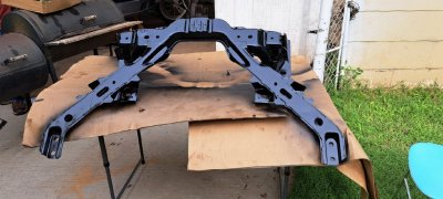

For any still here, I lucked out and found a k member on a GT. Also bought some wheel dolly and moved the car under the car port. This isn't everything I need but it's a good start, I'll post some more pics here in a bit. I can also get some pictures of the damage tomorrow

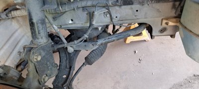

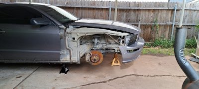

And progress so far. I don't think I'll be able to work on it this week but I can probably source parts. I'm gonna buy some new control arms and shocks online, and then try to pull off a rack and pinion assembly from another car. The hardest part, then, will be the rail. I'll get a picture tomorrow, but it isn't so gnarly, just caved in. I was having doubts on how I'd be able to get it trailered to a body shop, but I did have this trailered home in the first place, so it's definitely possible. Also, going to look into that EPAS conversion since I'll have to take the steering assembly out anyways

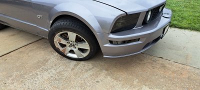

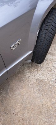

Damage photos. Last one is the actual structural damage. My dad and the tow truck guy both think that a new k member can be bolted right on, at least for the drive to the shop. I don't think that'll work, it might even bend the k member. Going to have to tow it to the shop like I had the car towed home, or I'll have to pay a guy with a flat bad.

I can't see how the new k member will bolt on. The holes won't line up with the floor buckled as it is, and it looks like you'll need to replace the swaybar since the end is bent backwards.
That was what I thought about this as well. I'm gonna see about getting that piece of rail straightened, and then bolting on the new parts. As for the swaybar, another item on the list
