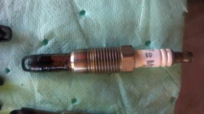

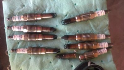

The tips are basically gone, I did a rough estimate of the gap and its around 55-60, no wonder it ran really rough. I have a turkey to smoke tomorrow, so maybe I can install the new plugs in and go from there. Looks like they were the original plugs too.
