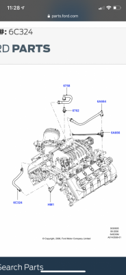

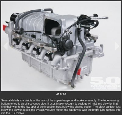

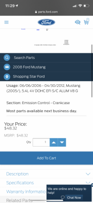

6719F136-060F-4F40-8D0F-75375F8033F7.jpeg EB724B9C-99B7-402C-B307-9F8519A3A701.png B3652D19-4062-42B5-8EF8-0762CE0AA37B.png It took me nearly a year to solve this mystery but here I am with an update.
The vacuum line that mounts to the rear of the supercharger, it leads down the behind the engine about 1 foot downward and connects to the lower section of the intake manifold... the Ford Parts website description is “Emissions Control - Crankcase” and the hose is given a generic name “Connector”.
well mine was rubbing up against the manifold, specifically a protrusion of aluminum on the manifold that has some sharp flashing. It cut through the vacuum hose.
I believe the hose is apart of the Oil Separator system.
