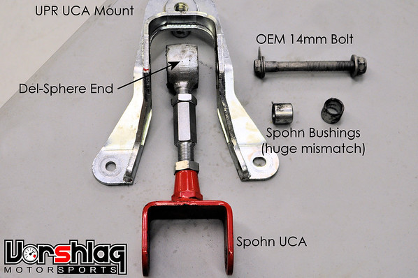

I know you have tested a lot of different rear upper control arms. What are you guys using now?
Earlier last year you showed a Boss302 S piece (maybe Multimatic?), and you had been using a Spohn/UPR/custom setup. I see you are selling the updated Whiteline one.
Just curious your thoughts.

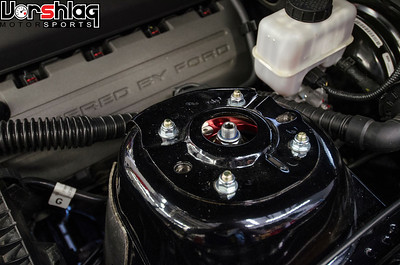

Yea, that's a good question. I'm not sure what I'd recommend right now. There are problems with using rubber bushings in the upper control arm load path, simply from too much deflection. Polyurethane is too stiff for the upper mount to pivot well, and that use can lead to tearing of the OEM rubber mount on the axle side for the UCA. So what's the solution for the UCA?
A spherical bearing. This type of bearing has a steel spherical ball and socket joint that can both pivot and rotate in two different axis. We tried the "Del-Sphere" joint in the above arm but it loosened up and made noise in a very short period of time. After re-adjusting the joint itself several times to no avail, we gave up and went with an all metal spherical in the upper mount.
The $700 Multimatic UCA arm and mount were based on the OEM bits, but it was very well made and the tolerances were much tighter than other parts we've seen. The upper 18mm bolt fit inside the included bushings snugly, unlike the loose sloppy fit of other units we tried before.
This price-point is out of reach for most folks, and this unit still doesn't address the bushing on the axle side of the UCA. So we're still looking for the right solution to recommend. There are some new brands out there that seem to touch on all of these issues, but we've got some other goals in mind as well. If we had time we would design and build something ourselves but we're just too busy at the moment.
For now I would leave the UCA alone. Most of the aftermarket solutions are more trouble than they are worth, and almost all of them make a lot of noise. The LCA arms are more important to geometry and do not need to pivot as much as the UCA does, so they don't necessarily need sphericals. The LCA relocation brackets are also crucial on any lowered car, so don't forget those. And then get the axle re-centered when you lower the back, by using an adjustable panhard rod or a proper watts link kit.

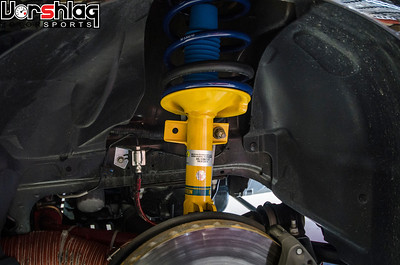

The buyer loved the car when he arrived, then wanted to upgrade it to the full Bilstein StreetPro struts, shocks and camber plates. We had what he needed in stock, got them installed in a couple of hours, took care of the sale at the bank, and then he drove it 1400+ miles home through an ice storm that hit the east coast, with a smile on his face. Weirdest thing... so many buyers appeared during a 48 hour period, I thought I was being prank called at one point. I guess I won't ever try selling cars in December or January again, that's for sure. Probably the magic of Tax Return Season.

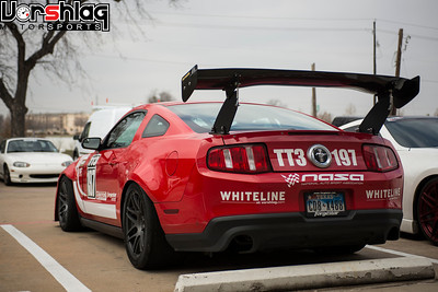

Rear Flares Finally Happened!
So if you have been reading this Build Thread for the past 4 years you will know that I've complained about the 315mm tires we have run at all four corners are a bit on the small side and lusted for MOAR TIRE. While the "315s are skinny" statement sounds crazy to many of you, remember: we have been racing at 3770 pounds (with driver) in NASA TT3 class, and the "weight-to-tire" ratio isn't all that great with this many pounds and only a 315mm tire.

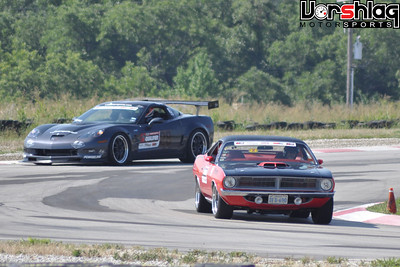

Typical TT1 C6 Z06 rear tire is a 345mm Hoosier, and these cars weigh around 3150 pounds stock, not 3550+ like our Mustang
Remember: the typical TT1 classed C6 Z06 Corvette (above) in Time Trial is on 18x12" wheels and 345mm rears under stock fenders, with the same power levels (440 whp) or maybe a tick more. And with a 400 (or more) pound advantage to our car, their "tire-to-weight" ratio is very favorable. We cannot run that light without removing large portions of the chassis, and bumping up classes, but have been making due with 315mm tires on a 3770 race weight, with similar power numbers as a stock Z06.

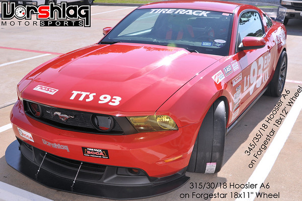

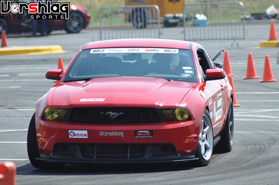

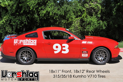

2012 SCCA ESP and NASA TTS wheel/tire set-up on 315/35/18 Kumho V710

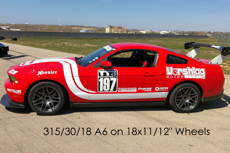

Let's back up and cover the tire and wheel upgrades we've made since ditching the 18x9" then 18x10" wheels and street tires of our first 2 seasons, when we were building around STX/STU autocross classes. After a switch to ESP and TTS classes, we started running the 315mm R-compound DOT tires back in 2012 with a Forgestar 18x11" front and 18x12" rear, both of which just fit under the stock fenders (with some tricks out back to clear the 12's and 3 degrees of negative camber in the front to keep the top of the tire under the fender).
Early 2013 NASA TT3 wheel/tire set-up on 315/30/18 Hoosier A6
We have since perfected the 18x11" wheel fitment at both ends of the S197 and realize that, for most racers, a 295mm-305mm tire works and fits best with that wheel size. Fewer tricks are needed to fit the 18x11" rear wheel and that tire width, compared to the 18x12". But for our "ballasted up" Mustang making 420-430 whp, and with as aggressively as I drive the thing on Hoosier A6 tires, we were overheating the 315s within 2-3 laps. So I bought a pair of the widest DOT radial tires made by Hoosier: the 345/35/18 Hoosier A6. They fit the rear 18x12s "well enough" and looked liked they fit the car without any fender mods (but didn't really).

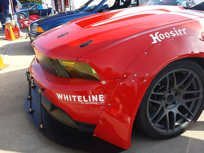

Ugly cut front fenders at Hallett 2013 clear the now wider 18x12" front wheels

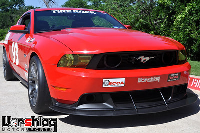

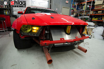

Before the June NASA Hallet event last year we cut the front fenders (a replacement pair of OEM units - the stock front fenders are in my attic, along with the OEM trunk, front bumper cover and hood) to clear a new wider 18x12" front wheel, to make the wheel set-up more "square". We ran it this way for a couple of months and in August of 2013 we finally made over-flares for the front. We made these in our shop using a vacuum formed ABS plastic material just before NASA Nationals last season, and made them big enough to clear a 335mm tire. But with stock rear sheet metal we kept all four corners at 315/30/18 sizes.
"Ugly but Functional" front flares. We say that phrase a lot, I know...
They were not the prettiest things to look at, but they were functional and aerodynamically correct - you want to COVER the entire FRONT of a spinning tire, as that reduces drag, and you want to EVACUATE the rear portion of the tire by leaving it UNCOVERED on the back side. This helps pull air from the wheelwell and undercar areas, increasing brake cooling + engine cooling and reducing lift. This is a trick used in sedan car racing and was easy enough to emulate.
Testing the mega-splitter at ECR, August 2013, days before making the front flares

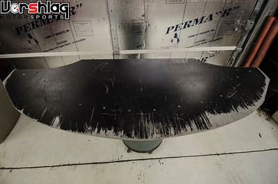

We added a MASSIVE front splitter to the car at the same time and integrated the front flares/wheel spats into it. I had wanted to flare the rear wheels at the same time, and switch to the 335/345 tire combo before Nationals, but we simply ran out of time (and Amy said NO!). After Nationals I wanted to attack that at our shop, as we've done steel flares as well as wide-body conversions in steel before, such as these cars below (but Amy said NO!).

When we realized late last year that the all new 2015 Mustang was going to likely be delayed until Fall 2014, and decided to keep the 2011 GT and race it in the 2014 season, I REALLY wanted to do the Big Tire Upgrade. RIGHT. THEN. AND. THERE. But we were too busy to tackle the rear flares, so I called Shiloh at Heritage Collision in Sherman, Texas, who had done such an amazing job on the custom flares for McCall's Z3 LS1 project (above). He worked the rear fender contours to clear that car's massive rear tires, then made front flare sections that he integrated into a carbon fiber hood, then made flared lower fender sections to blend it all in, and even fabricated some little splitter sections for the nose. That car looked AMAZING, so I took him the 2011 Mustang...
Dropping the car off at Heritage Collision in early February - 345s installed and spaced out 1/2"
Amy was NOT AWARE that I had done this, of course, as I knew she wouldn't approve. I figured it would better to ask for forgiveness than permission in this case. So it was done during a very hectic time in the shop, hoping she wouldn't notice the red Mustang being gone for a couple of weeks during the ~5 week break between Race Events we had from Jan 31st until March 8th.
Our shop guys (Ryan, Kyle and Olof) had blown apart the front splitter, front grill block-off plate, bumper cover, and rear wing uprights to have all of the aluminum bits blasted and powder coated (no more rattle can black paint or raw metal), as well as the Gloss "White" wheels (which were to be blasted and powder coated Anthracite grey with a semi-flat clear coat) then we loaded the car in the trailer and I dropped it off at Heritage. I discussed the timeline, budget and look we wanted with Shiloh and he said it would take a week or two. Well in 2 weeks we had our annual Open House and SCCA Tech Day, and I wanted this car to be there, so that was the absolute latest deadline we agreed upon.

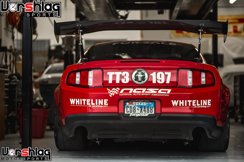

Behind The Scenes : Making Custom Steel Rear Flares
Trust me - you don't want to see this kind of bodywork being done on your pretty car. Here's are some pictures that Shiloh was texting me while the rear flare work was ongoing, and my near mental breakdown that ensued. At first he showed me a method (these two below) that might have worked with a narrower tire, if we didn't need the extra clearance for lateral movement of the axle (even with a Watts there is some movement + tire deflection).
Before and After - this was just the outer panel separated, moved out and massaged. "Looks great!"

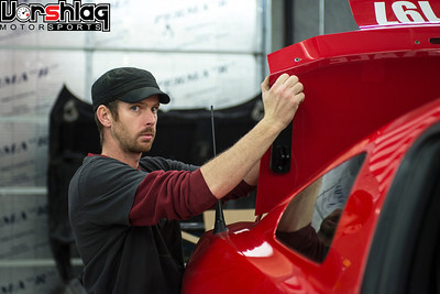

He cut the tack welds that join the outer rear fender skin to the unibody inner structure and WORKED that panel out about 2 inches. It covered the edge of the 345/35/18 tire we mounted to the 18x12" rears just barely, and it might have worked.... for hard parking but NOT for road course use, though. This method yielded about 1.5" more wheel clearance and never even touched the paint. It was beautiful, and damn I wish that would have been enough. But we were already getting tire rub with the 315s on the 12" wheels under the stock fenders, and the new shape really needed 3-4" of additional room or flaring beyond stock to clear the 345s and a potentially wider 18x13" rear wheel (coming soon, I hope?)
"Wait.. what just happened!?!"
After those pictures got my hopes up, he sent these terror inducing "making of the sausage" pictures. At one point I sent him a text: "AHH! I'm freaking OUT! Please stop sending me pictures until it is in primer!" ;) He said to have faith, and reminded me that he had never let us down in his paint and body magic before, so I stressed out for another week while they made ALL NEW FENDERS from steel, added 4" of wheelhouse to the outboard side of the inner fender, and got the shape bodyworked and perfected.
That SHAPE was looking much better, but I still couldn't see the final look in raw steel. Once the bodywork was done and the fenders were in primer he sent me these pics below ...and I calmed WAY down. Unlike a lot of flare jobs I've seen, Shiloh and his guys at Heritage understand racing, proper suspension travel and tire clearance under full bump loads - so they pulled the rear springs and compressed the tire up into the fenders they created to make the most room possible. This adds a on of work, but that's the right way to do flares. Shiloh said that this same job would cost around $3000 to fabricate, test fit, clearance, weld, seam seal, bodywork, prime, block and paint if he were to do S197 flares like this again. Two weeks of late nights and LOTS of hours, but now LOTS of tire clearance. We've sent lots of racers and friends to Shiloh for paint and body work and it is worth the drive north from Dallas - they are that good. If you are in or near DFW area and need crash repair, custom paint or wild flares like this made, call Shiloh at (903) 891-3040.
But by now Amy was getting suspicious, and I couldn't keep her out of the shop every night she came in (after her day job) to do our accounting work. Luckily, with end of year bookkeeping she was pretty busy and somehow never noticed her car being gone. Now I never lied to her, and if she had asked "where's the Mustang?" I would have fessed up immediately, but I dang sure didn't volunteer the information! :p
We took it down to the wire, as Heritage needed the full two weeks we had before our deadline to get it bodyworked, painted and buffed. They even painted the ABS front flare sections for us, as the red vinyl wrap job we had done was not sticking well and starting to peel off. Shiloh really wanted to make steel front flares for us, and I wanted him to as well, but we simply didn't have time.

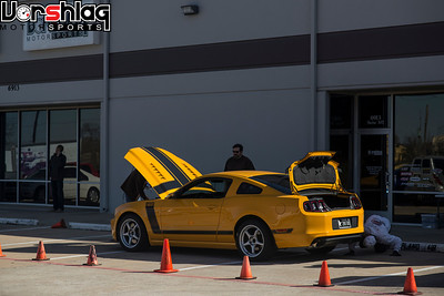

Vorshlag Open House + SCCA Solo Annual Tech Day, Feb 22
Picture Gallery: http://vorshlag.smugmug.com/Car-Shows/Vorshlag-Open-House-2014-SCCA/
This Open House event went even better than the two previous years' did, and we had 100+ people through the shop that day. Dozens came for the SCCA Annual Solo Tech, which saves them 15+ minutes during each of the 9 autocross events that Texas Region SCCA SOLO holds each year.
Lots of our customers came by, and we had tons of food and drinks. Breakfast was kolaches and donuts and lunch was catered Mexican food by Ryan's mom's place, Ojedas. MMM, mmmm it was good! We also had cake, cookies, chips, queso, salsa, and lots of beer.
I never sat down from 7 am until 5 pm, when it all wrapped up, and I talked so much I was hoarse. Lots of people looked at the Mustang's new flares, the C4 Corvette cage we had just built, the Scion FR-S and NB Miata LSx Alpha projects, a customer E36 M3 LS1, among other projects underway.

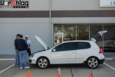

One of our customers, Tyler, brought his Unimog out that day and rolled up in line for tech. The SCCA tech guys just shook their heads and laughed. He then proceeded to drive up every incline in the surrounding property in front of our shop, giving rides.

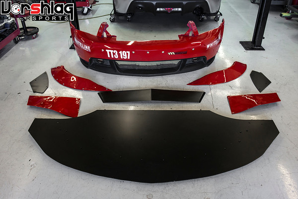

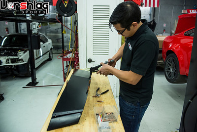

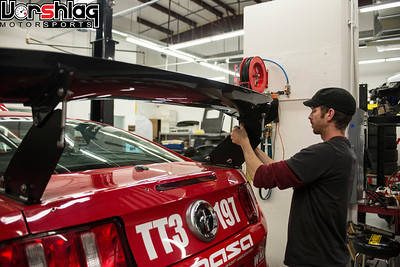

During the Open House Kyle stayed busy all day, when he re-assembled the Mustang's splitter and front end, installed the wing, and then worked on a customer's Corvette race car - all while the rest of our crew was eating food, drinking and goofing off. Nicely done, Kyle!
To be fair, Olof helped him for the Mustang front end, and mounted the 335 tires on the newly refinished 18x12" front wheels. Of course Brandon was busy taking pictures all day and we were all busy talking to folks and giving tours of our little shop, too.

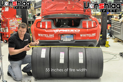

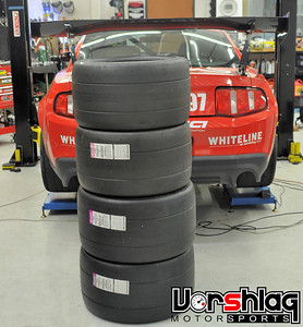

New 335 front 345 rear Hoosiers + New COBRA Seats
So the whole point of (last year's) front and (new) rear flares was to house these wider tires. We knew the 335/30/18 Hoosier A6 fit up front, and I had a pair of scrubs that were mounted up for the Open House. The rear got another set of scrub 345/35/18 Hoosier A6 tires, which I have about 10 of (from the pair I purchased earlier plus some more I acquired).
The sticker set got here today. So the plan is that we will have the Mustang loaded in the trailer on the four scrubs, with the sticker 345s mounted on the spare 18x12" rears and the sticker 335/30/18s loose in the trailer. Blast out to MSR and test in the afternoon on the 1.7 mile course on the scrub tire set.
Then take the front wheels off and mount the sticker 335s trackside at PST (since Amy busted one of the extra pair of front 18x12s at MSR-H and the replacement isn't here yet). That Friday night I'll mount the sticker front and rear wheels onto the car after I'm done testing.

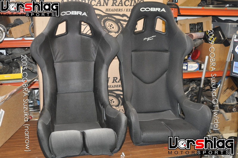

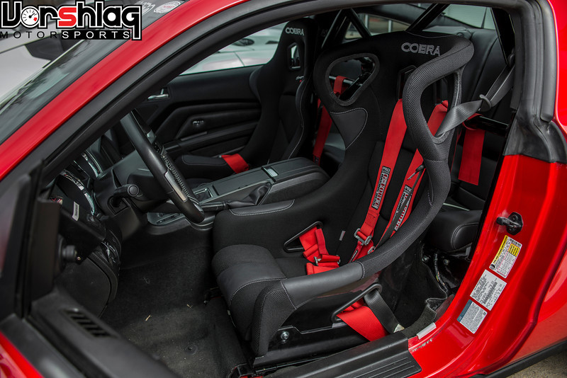

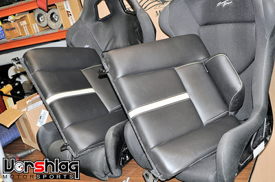

The old seats that came out of the 2011 GT. These will be for sale on our Clearance Page soon.
While we were getting the car cleaned up for the Open House I noticed how faded the COBRA seats have become. The passenger seat, a narrow ("normal width") Suzuka kevlar fixed back composite racing seat, is from 2005 and with nearly 9 years of use in two of my cars without tinted windows, that often get parked outside during the day (to make room in the shop to work), is fading fast. And it is a bit narrow for most folks, so my passengers have had to suffer (it is really made for folks under 160 pounds). The driver's seat is also a Cobra Suzuka, but the "GT width" version (wide, which fits 90% of the people in the USA) from 2009. The fabric is perfect on that one, but the outer left side edge has seen some sun fade also. It isn't noticeable unless you sit it next to a new set, though.
But with an event in March that will be televised (USCA) I wanted to put in a fresh pair of COBRA seats, and get that narrow passenger seat upgraded to a wide version, that will make it easier to give rides at track events and autocrosses. So I took the Cobra Evolution GT seat from our lobby, and another Cobra Suzuka GT we had in stock, and had Olof and Kyle put them in the Mustang. They had to modify the (fixed) bracket on the passenger side, but it is all good now. We routed the OEM seat belt through the head protection section and down through the lap belt hole of the Evolution seat, and it fits across my shoulder and hips just like it does on an OEM seat. So yes, a racing seat can be safe in a street car, if you keep the stock belts and route them properly... I had a whole article written about seats, roll bars and harnesses (for autocross, track and street use) but it needs some more edits. I'll post it in a week or two.

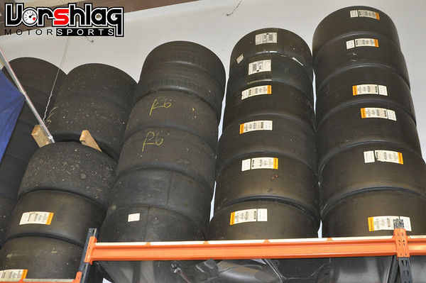

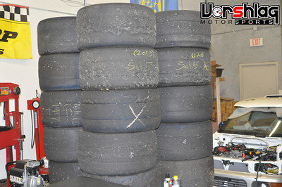

Call Vorshlag For 315mm Scrubs!

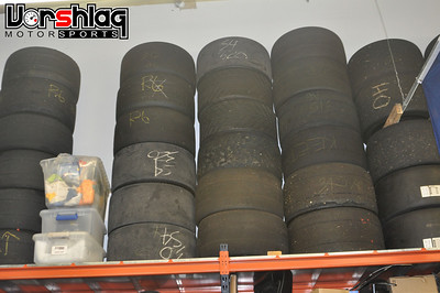

So now that we've finally made the switch to 335/345 tires, we've got a shop full of my used Hoosier A6 (and even six R6s) DOT race tires in 315/30/18 that we need to move. They have been stored in our climate controlled shop and all are less than one year old. These are all my TT scrubs, and I've been saving and hoarding them from last season - I think I used 32 new A6s last year, and most of them are still here. They'd all work great for autocrossers, even track guys - if you don't mind the fastest TT laps have been taken on each set already. These cost $376 new, selling them for $100-125 per tire. Call us and see if we still have any left. I'll be moving the 335 and 345 Hoosier scrubs pretty soon as well.
And of course we still have several sets of new Continental 305 and 320/650/18 racing slicks. All of these are either in our Clearance Page now or will be soon.

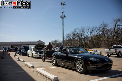

Cars and Coffee Dallas, March 1st
While the pilot episode of The Car Guy Show was airing we were at Cars & Coffee Dallas once again, bright and VERY early Saturday morning, parking with the SCCA Solo folks to promote their events. We drove out on the Hoosiers, this time the 335/345 scrubs that I will test with on Friday. The crowds flocked to the car even more this time, as the rear fenders were fairly obnoxious looking. The Car Guy Show crew also brought out a couple of cool cars, including this Viper and this Mosler MT900, which parked next to our Mustang.
Picture Gallery: http://vorshlag.smugmug.com/Car-Shows/Cars-Coff030114/
They filmed some B-roll out there and a few brief "we'll be right back" segments with some folks. Vorshlag's Ops Manager Sofi rode her Cafe themed Honda motorcycle (that she hand built) and also parked with us. The weather was PERFECT and the lot was jammed with 1200+ cars and thousands of people.

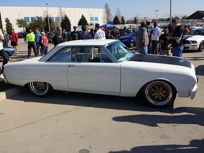

At about 10:30 who walks up? None other than Aaron and 5 of his guys from Gas Monkey Garage. Even though he hates Mustangs, Aaron stopped and talked to me about the car for 20 minutes, and we realized that one of his crew was someone I knew that used to work at a shop we dealt with a lot. Then the subject of his '63 Falcon came up and the Pikes Peak 2014 race, which Aaron is entered in. We've supported racers at this event in the past, and Vorshlag's head engineer Jason has crew chiefed there 4 or 5 times, and will again this year.
Left: Me chatting with the GMG crew. Right: Aaron's recently purchased 63 Falcon is sweet!
We talked a bit about the tricky nature of this treacherous hill climb event, the altitude and prep you need to tackle. Aaron is going to be getting more seat time in the Falcon at NASA events, a Bondurant school, the upcoming Goodguys autocross, and the Ultimate Street Car Association's event at TMS this month as well. Our own beared wonder Jason spoke with Aaron at the PPIHC event last year, and I suspect they will trade some more Pikes Peak stories at one of the events we will see the GMG guys at in the coming months.

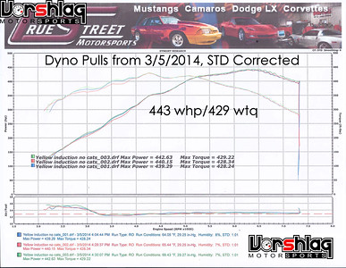

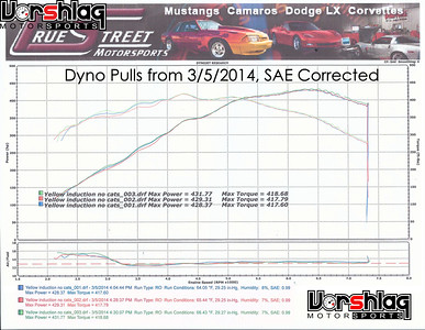

Yesterday the tuning gurus at True Street Motorsports in McKinney, TX made time for us in their busy schedule and we got them the 2011 Mustang for a re-tune and dyno check-up. We have changed the exhaust (added the lighter Magnaflow mufflers and dumps) and needed a re-tune and NASA Time Trial Dyno Certification Form for this season. We don't plan to make any more changes that would affect power.
Dyno pulls from 3/5/2014. Left is STD correction factor, right is SAE correction factor (which NASA uses)
So in the past ~8 months we had been making from 419 whp to 421 whp and around 402 wtq, right before Nationals and again in a late December dyno test. That's the number we used to get to that 3770 pound TT3 race weight, which we used to ballast up about 45-85 pounds to meet (depending on fuel load and driver). Well this new dyno pull kind of threw a kink in those numbers.
Left: New TT3 classing sheet, page 1. Center: New TT3 classing sheet, page 2. Right: Dyno Certification Form
The 442 whp and 429 wtq STD corrected numbers were a little shocking, until I realized that the SAE numbers were only 432 whp and 419 wtq - SAE numbers are what NASA uses to get to the correct power-to-weight for our TT class. I've included the updated TT1/2/3 classing sheets as well as the dyno certification form. I did the calcs and it looks like the bump in power was only a modest bump up in minimum weight, going from 3770 to 3802 pounds with the new power boost. This was helped by the fact that at 3801+ pounds we get the highest bonus possible from weight, +0.6. The non-OEM aero penalty is -0.4, taking the 9.0:1 base TT3 ratio to 8.8:1. Then if you do the math... 432 whp x 8.8 = 3801.6 pounds, rounded up to 3802. While it might seem backwards how we came up with these numbers (and it is opposite of how the TT sheets have you calculate it), this is exactly how the NASA TT National Director (Greg G) showed us how to do it at the 2013 NASA Nationals.

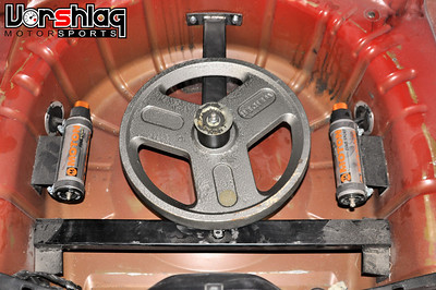

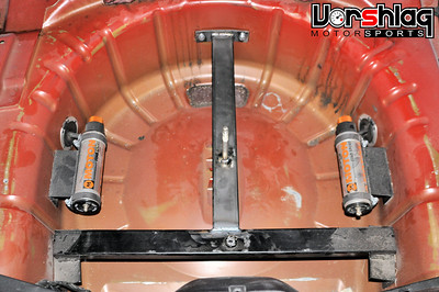

I asked Olof to modify the existing weight box bracket to make it a bit more robust ballast, to hold additional weight. I never liked the old one (it was the black 1x2" tubing that bolted in at 2 points/4 bolts), and the new design is a "T" shape with two more mounting bolts + an all new thicker/stronger M14 bolt to secure the weights with. Please don't over-analyze this brace - you can lift the back of the car from that bolt and brace.

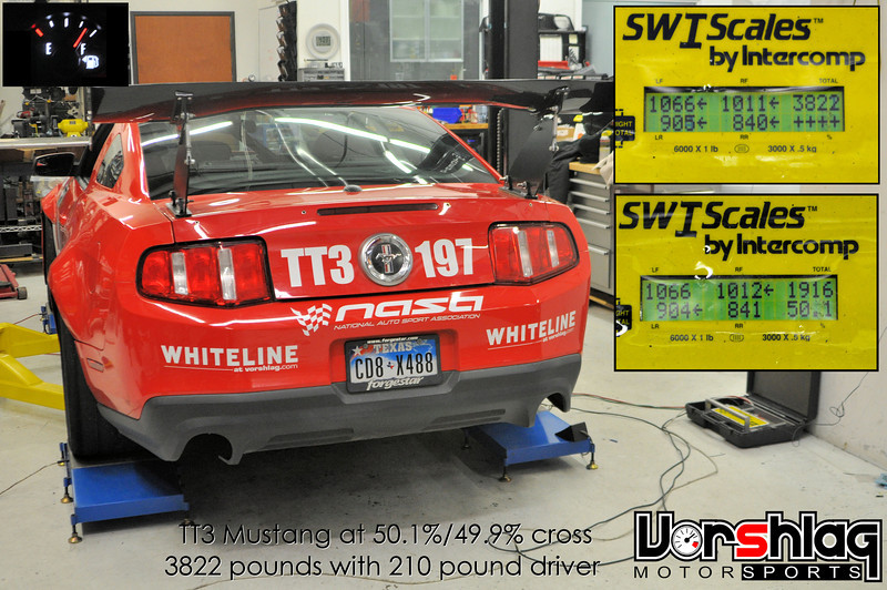

We figured the new flares and especially the much wider (and taller rear) tires would add some weight, and boy it did. With nearly a full tank of fuel and me sitting in it (210 pounds, been eatin' good!) with my helmet and the new weight box bracket we're at 3822 pounds sans ballast, so that is overweight now by a solid 20 pounds. And that was after removing the rear seats today (33 pounds) because it was way over minimum an hour earlier. Granted it has about 80 pounds of fuel in it, and it can probably go down to 1/2 tank on this course safely, but dang this car is heavy. Those new tires added some pounds, but a lot of added width - should sill be quicker, I hope? We will see soon enough.

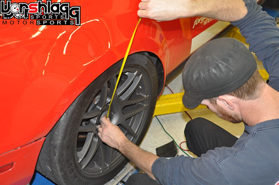

Olof and Kyle did a ride height change in the rear - Shiloh had it "tucking some tire", which looked cool for pictures but it bottomed out on the street a bit much. Then they did a corner balance adjustment to get the cross weights even.

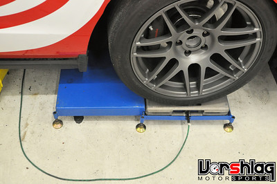

Getting a quick corner balance done on the car after some changes. It was at 48.2/51.8% cross but we got it to 49.9/50.1%
And yes, for TT2 we're still WAY too heavy (even without ballast) and WAY down on power to hit the power-to-weight ratio limit for the class (for us it would be 8.0:1 -0.3 for weight = 7.7:1 at 3500-3600 pounds). We'd have to drop nearly 300 pounds and gain another 30 whp to hit the 7.7 ratio (3500 pounds and 454 whp) to max out for TT2. I think we've found the limit of power for this car with a bone stock engine from throttle body to exhaust port, and I don't want to dump time and money into a built motor and gutting the car to get to that weight. Not even going to entertain that idea.

Mmmm..... big flares.... big tires.... NASA @ MSR means it was time to finally use these in anger!
We drove at MSR track in January with SCCA Club Trials to a 1:18.675 on used 315mm A6 tires, so I was hoping for a 1-2 second time drop with a sticker set of the wider Hoosiers on the same 1.7 mile course... if we even ran the 1.7 course. You see the NASA Texas Time Trial group is normally too big to fit on the 1.7 so we normally use the longer 3.1 mile course - and have done so for the past three years (2011-13). We've had as many as 47 cars enter into TT group at our events, but this time we only had 26 signed up about 4 days before the event, so Dave B made the call, "TT will be running the 1.7". The cut-off for minimum TT entries to run the 3.1 was 32 cars, and we just didn't make it in time (but we did by the end of the race weekend!)

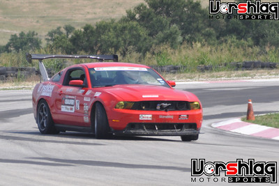

Went out dead last in TT, about a minute after they had left, so I blasted out of the grid and caught the back of the field on the formation lap then scrubbed the sticker tires a bit. Costas snuck out there in his GT-1 car late as well, but held back and left a half lap gap to me, so he had all sorts of clear track on his first couple of laps. Smart! I caught a ton of traffic on every lap, of course, but everyone was cool and I was passing 3-4 cars per lap. Worked my way up through the field and took five laps, which is a lot for this car in TT (normally overheating the tires by then).
I can smell and hear a tire rubbing and smoking, and eventually I figured out that the right rear is rubbing inboard badly. Then I finally remembered which spacer I was supposed to change - the rears! I really needed to get a sub 1:20 lap so I took a few more laps even though I saw and heard the tire rub. Needed a fast lap to get up the grid for TT session 2, so I wouldn't be mired in traffic and slow all day. That was probably a mistake, as when I finally did come in I had damaged the tire a bit more than I figured.
Did manage a 1:20.4, which was 4th fastest and moved me up the grid. Way better than I thought I'd get with that much traffic and these cold temps, so I guess it helped after all. We ended up having 29 cars for the day after 28 signed up, some didn't show, and then we had several new drivers get check rides from HPDE 4 and move up to TT. I came in, pulled the rear wheels and put the correct spacers on back there. Checked the tire, despite the rub, it was still OK and had not cut all the way through the outer rubber and into the carcass. Made quite a big "tire baby" out of the shaved rubber from the right rear. Oops.

This ZR1 racing in TT1 at MSR is using the factory Traction Control system - which is one of the better ESC systems
A very few OEM TC systems are racier than most, but the factory S197 TC/SC system pretty much sucks on track, wet or dry. A bit of yaw is helpful in road course driving and especially autocross conditions, to "pivot" around tight corners. I will often go through even high speed corners with some "slip angle", as this allows for higher lateral loading. Forward acceleration on track is also better with these OEM systems turned all the way off.

Like many S197 racers we are using a single a 3" brake duct hose coming from the fog light openings right now but we had just re-routed and lengthened these hoses to avoid the 335mm wide front tires at full lock (see new routing, above). I fear that the new cooling hose routing (now located inboard of the splitter's rear mounts) with tighter bends in the hose is causing some additional airflow restriction we weren't seeing before. The rear calipers even saw over 350°F, which was a tick higher than expected. We will replace these Alcon indicators for each event and monitor the max temps reached on each caliper and possibly add a second 3" hose (or move to a 4" hose) up front and maybe even add some under-car ducting for the rear brakes. I have an idea for that which will tie into the new rear bodywork nicely and discretely.
We've run multiple brake cooling hoses to the same corner on other cars we've built before, like this C4 Corvette above. That one used a massive inlet duct, air passed through the frame rail then was diverted out into two duct hoses: a 3" hose routed to a custom brake backing plate for the inside of the rotor and a second 2" cooling hose pointed right at the caliper. This system worked very well and in that car's first 12 hour of racing the pads barely wore halfway, but the rear brakes (uncooled) went through two sets of pads. We might try this "dual cooling" set-up on front of the TT3 Mustang, or a single 4" hose to the rotor, or a dual 3" hose to the rotor. And a ducted rear rotor set-up is coming as well.

Making Weight by the Hair of My Chinny Chin Chin!
One little scare I had on Saturday was after TT session 2. I came after running that 1:17.7 lap and was sent to the scales. I wasn't too worried, as I had thrown a 25 pound ballast weight plate into the trunk mount moments before the session began, after I noticed a somewhat lower fuel load than I had wanted (normally I was going to grid with 7/8ths to a full tank). I made weight that time by 2 pounds!!!! And that took two tries...
The first time they put the car on the scales after that session it was 8 pounds light. As per the rules, that would have been technically legal on my first weighing of the day (10 pound grace on first weighing) but I knew that weight couldn't be right. I asked them to roll me off, make sure the scale pads were under all 4 tires all the way, and we rolled it back on. That time it was 3804 pounds on a 3802 minimum. Whew!
I went to the paddock and immediately threw 20 more pounds of ballast and a full tank of fuel went into the car for each successive session all weekend. I was weighed a couple more times; once it was 3835 and another it was 3853 pounds! So getting spooked by that "close call" 2 pound weight check made me run too much ballast all weekend. I'm sure with our crew here I wouldn't have overshot that so badly, but oh well. It was fully 51 pounds overweight on my 1:17.310 lap Sunday.
Jason Toth (the Alpha LS1 Miata owner) made his TT debut on Sunday in an Audi A4 (loaner, shown above left) and had a blast. He borrowed my spare AMB so he graciously ran in TT3, which made for 7 in class. Hoosier pays all the way down to 2nd place so Jeff Tan won a tire that day in 2nd and I won 2 more in 1st. Which was good, because I blew my tire budget all to pieces with the new A6s for this event and BFG Rivals for Goodguys/USCA. I'll save the newly arrived 4 tire winnings for April's NASA TT event and use 3 of these 4 tires from this weekend as my Friday test set if we go down there a day early. Gotta get a replacement 18x12" wheel so we have two complete sets - running around and getting tires swapped and mounted minutes before my first TT session Saturday was a bit too hectic. Congrats to Mike Patterson (shown above right), who won all 4 AI races, reset the track record for that class in the low 1:20 range (on the new Toyo RR tires running 18x9.5" Forgestar F14 wheels he bought from Vorshlag), and ran in TT3 both days as well. He also works as race director for another race group, so he was a busy man!

I realized quickly that this was the same course we ran in October. Exactly the same, really, but one of the Pro drivers (the Fri-day-Saturday group is broken up into groups and the shops and drivers that go to most of the Goodguys events and do well get assigned into the "Pro" category) said it was different by a couple of feet here and there. Regardless, having run this strange layout in October was a big help, since I knew I wouldn't get lost this time like so many did at that event. I walked it one time and got back into the Mustang to stay warm!
When the event finally got underway around 8 :30 am the Pro class drivers went first, which they are allowed to do. They park by the announcer and put on a good show for the crowd, but they aren't competing in that day's events. Many of the 1972-older domestics that ran Friday-Saturday also take runs throughout the Sunday, but they also aren't in competition - just making fun runs. A little frustrating for those of us that are competing in the All American Sunday (1973-newer) event, but they paid their money and they get their runs. It makes the day more interesting, as just late models autocrossing can be boring for this crowd of spectators - which was a surprisingly full crowd all day, considering the weather.
I had one of my student's from Sunday's SCCA Solo School where Amy and I instructed who was at this event, Lloyd in the red Boss302. His son was with him and he wanted to get a ride in our car, so I took a rider on my first run - and only on this run. Last October I took riders on all of my Goodguys runs, but when you lose by .02 seconds you begin to get paranoid. I knew this first run would suck, and it did. The BFG's still had visible decals and mold release and it felt like driving on ice. He had fun and I got that awful run out of the way. You can see in these pictures that we were wearing helmets, which I'm so used to doing, but nobody else was because it isn't required at Goodguys.
And while the course ran very near fences and concrete barriers it doesn't seem to phase anyone at these events, so I just went with the flow and drove my laps. My first lap was a 77 second run, which was terrible... but after the first round of runs it was in 1st place somehow. Then I made a second run of a 74.4 second run, which was painfully slow and I had wheelspin everywhere, and now I was 4 seconds in the lead. Huh?
The lines were heavy and growing all day and it was taking about an hour between runs, but I was used to this from the October event. By the time I got to the line for my third run it was around 11 am, and they said they'd pick the fastest time run by 11:30 and call them the winner. I pulled up to stage and the guy is plastering decals on the car for "Autocross Winner", and I hadn't even made my last run. "Nobody is close" he said, and then I was told to report to the timing tent after my last run, shown below.
That run felt a little better, and I made all of my 1st gear downshifts shifts smoothly. The wheelspin was more controlled than my other two runs but there was still VERY little grip on this still wet asphalt in these crazy cold conditions. The BFG Rivals apparently don't do as well as the Falkens in cold temps, and Brian Hobaugh was stupid fast on Falkens in his gorgeous orange 2nd gen Camaro, running several seconds quicker that day than me. But he and the rest of the Pro class drivers were in the 1972-older series and luckily their runs didn't get compared or counted with ours'. Next weekend at USCA those cars are in the same class as me, so I am hoping with warmer temps and better driving I can get closer.

We had installed a Cobra Suzuka GT kevlar racing seat into his car a while back, using the custom S197 bracket we make to go with the Cobra slider and Cobra side mount brackets. He loved the new Corbeau S197 Harness Bar, new seat and 6-point harnesses and raved about how much more control he had gained with this seat. He drives the car to events from as far as 5 hours away, and does a lot of track and autocrossing in the car, on both street tires (295/35/18 BFG Rivals) and R compounds (315mm Kumho V710s).
He loved the new driver's seat so much he went ahead and sprung for a passenger seat upgrade, which any track instructors or passengers will greatly appreciate. If you do one seat you really should do the other side as well. To save a bit he went with the steel framed fixed back Cobra Monoco seat on the passenger's side, which was about half the cost of the kevlar Suzuka. It only has about a 2 pound penalty in weight over the composite seats, and being a Cobra product, it still looks great and has very high quality construction and materials (I ordered some more of these seats for inventory). He skipped the slider on the passenger side and we just mounted the seat fixed to the bracket, fairly far back and lower than it would have been with a slider - which is what we often do on the right side seat.
Another change he had in mind was a new rear Upper Control Arm assembly. After reading what we had to say about poly bushings, Del-Sphere and all of the other variations on the upper arm and mounts he went with some brand new "ultimate" UCA from BMR, shown below. The instillation was straightforward, but still time consuming. You need a lift, removal of the back seat, and a BIG torque wrench for the main bolt (which should be torqued to 250-300 ft-lbs, depending on the brand - see your manufacturer's instructions) to tighten the mount to the chassis. The pinion angle also has to be adjusted, and there is even a second set of holes in the chassis mount for potential geometry changes.
The upper control arm is one of those places where a spherical seems like the right choice, as this bushing has to pivot much more than the LCA bushings do. And to match the new upper arm's spherical he went with a Steeda spherical bushing replacement on the axle side of the UCA arm axis also, per our suggestions.
Getting the OEM rubber bushing out of the axle side is a real B!TCH of a job. The instructions say to cut out the old bushing, but if you make a tool to press it out you can re-use that to press in the new Steeda assembly. Then when you go to tighten the 58mm (?!) hex nut for the new spherical you might need to make a tool for that as well...
After finding a massive 58mm socket for around $35 we had to chuck it up in the lathe to machine the outer diameter down for clearance, otherwise it would not fit in the space between the axle housing and the bushing mount. Really fun job, that one, heh. After all of this work was done I drove this car around our Test Loop (bumpy road we use to listen for creaks, pops and noises plus to test ride quality) with Mark in the car and we both agreed that it makes a LOT more noise inside now. We had previously rebuilt his entire axle with all new bearings when we did the 3.31 gear swap, and the rearend was silent as a church mouse just hours before, but after the double spherical UCA set-up was installed it was much LOUDER inside the car - and he still has the back seat installed. Just know that this particular UCA set-up adds a lot more NVH than you might expect - you will hear all sorts of noises from the rearend that were masked before. Mark said he likes the feel of the new set-up but needs more seat time to give a full review. You can read his build thread on s197forums here and he talks about the new seat and the BMR UCA in post #262.

Hoosier tire winnings from this weekend stacked up next to a new set of 225/45/15 BFG Rivals for Mike M's Miata. Wow.

It had these faults with the 315/30/18 Hosiers at all four corners and is just as bad or worse with the mis-matched 335/30/18 front and 345/35/18 rear (very different tire heights). The car cannot make a single hard lap now without faulting the TC system and/or going into limp mode, so we have to take drastic measures now. Even with the system turned all the way off the TC is turning itself back ON midway through my lap, and flashing all sorts of things on the display.
I think with the extra grip of these tires + aero we are running it is just too far outside of the factory parameters? I am not faulting Ford for this - we've taken a simple OEM Mustang farther than they'd probably intended. I also don't want to encourage people with street/track Mustangs to think they need to ditch the OEM ABS/TC modules - this Ford Racing module is an upgrade made for race cars with big, grippy race tires. If you are reading this and are not sure if you need this ABS/TC module, then you don't. If you are racing a 2005-up Mustang with the OEM ABS/TC system in place and are seeing all sorts of faults and problems when racing, you'll know.

Dallas area's Aaron Kaufman from Gas Monkey Garage was entered in his 1963 Falcon (which he is taking to Pike's Peak this year), but he only ran on Sunday in the road course event. From what I heard there might be a conflict with his Discovery channel TV contract, so he and his car probably won't be shown on the episode that was filmed at this event. Too bad, the car looked great - but Brandon got a lot of good pics of his car.
We spoke again at this event with Aaron and a couple of the guys from the GMG shop - all super nice folks. Marc even tried to get Aaron to co-drive with his team in a ChumpCar race at Daytona in May, in his "Poorvette" C4 Corvette that we caged. That car is a riot!

Next we have the last of the used Cobra Suzuka Kevlar racing seats from our Mustang. This is the "normal width" (aka: narrow) Suzuka, best suited for folks under ~175 pounds. We had this on the passenger side of our car for several years, and it has of 2005 build tag. It is in decent shape, with no tears or rips in the fabric but it does have significant fading of the material. It basically went from Dark Black to a Slightly Less Dark Shade of Black. We replaced this and the driver's side Suzuka "GT" width seat about a month ago with a new set, to better show off the current Cobra models we sell. The used driver's side Suzuka seat lasted exactly 48 minutes after we posted it for sale on our clearance page, so if you want this click here and buy it. Once its gone, its gone.
Last but not least, we still have multiple sets of the new 305 and 320mm Continental DP racing slicks as well as a many pairs of used Hoosier DOT racing tires we need to move. Stacks of tires are all taking up far too much room in our overly crowded but climate controlled shop. The Contis are normally about $2000 for a set of 4 but the we have dropped the price on these brand new race tires to $550/set, below what we paid for them.
All of the used Hoosiers listed right now are 315/30/18 sized A6 tires, which until very recently was the tire we used on our TT3 Mustang. I normally hoard my old race tires, but since we moved to the 335/345mm tire sizes on our Mustang, the crew here is grumbling at me to move out these 315s. Each Hoosier has some tread left, and we have listed each pair currently for sale with pictures of the actual tires being sold and DOT date codes from the sidewalls.

Once the Autocross course finally went hot around 10 am I got in a fast first run. I was lucky to have Amy, Kyle and Jason spotting on the course, listening for times, and helping with tire pressures and getting me ready before each run. I made a few more good runs in the first session by the time we were told to switch events with the "Even" group. At that time I was temporarily in the lead for the Autocross. We came back to this area 3 or 4 different times that day, and I quickly found out that my early leading times had fallen. I was in the low 43 second zone in the morning but the big gun drivers were already in the 42s and Brian Hobaugh was in the 41s. Yikes! I stepped up my driving and worked the tires hard, trying to maximize rear grip.
The rear tires became the limiting factor in everything on the autocross course that day. Yes, even with 335s on the back the car struggled to put the power down from this stock Coyote 5.0 (433 whp SAE). I was pushing the car to the edge of the cones, and picked up more than a few cone penalties that day (often just stepping on the cone bases, which is verboten in USCA). The event announcer (Dennis Pittsenbarger) was noticing my quick-ish times but was quick to also point out my penchant for cone penalties, and dubbed me The Conekiller, heh. He had nick names for lots of people, like "Cookie Monster" for Jon Miller - who had won a big bag of cookies in the Poker Run - and "Five Eights" for Marc Sherrin. He kept all of us informed as well as entertained all day, standing atop Optima Prime announcing.

Left: Our latest ballast weight rack, now with MCS remote reservoirs installed. Right: Our Mustang on the autocross course
We had the TT3 ballast plates removed (above) but the Mustang still pushed 3550 pounds, then add another 200 pounds for me. Many of these top Pro drivers were in purpose built muscle cars and were much closer to 3000 pounds, which was the class minimum weight for the "GT3" class - the class we cared about.

Stuart from Maxcyspeed came out and gave me some pointers for the shocks, and we made some time up after his damping suggestions. We also tried all manner of tire pressures and the car stopped best with the pressures we had dialed in on the autocross course, with about 31 psi up front 315s and 33 psi in the rear 335s. We changed shock settings for the speed stop and autocross, however, and made more shock changes for the Sunday road course. This event was the last time we ran the Moton Club Sport doubles, and now we have to re-learn the car on the MCS doubles (luckily they are very similar in look, construction and function).
My first speed stop was in the 12.4 second range and I spent the entire day working on my driving, trying different lines, tweaking my braking points, and just flat out beating on the car to get every tenth we could. Hobaugh and Finch were once again leading the charge and I chased them all day. I spent all morning mired in 7th place, then worked my way into 6th, then 5th. After a brief rain shower that took a good long time to dry off of the speed stop course I went back and was "hot lapping" this course with Bret Voelkel, Brian Hobaugh and Danny Popp. Some of the guys were doing big, hairy burn-outs to try to increase starting line traction - there was just very little grip in the starting box.

Cheryl Herrick's beautiful Chevy II (above) from Jet Hot won this event, and if you had seen it up close you'd know why. That car was amazingly well prepared and scored a 72.2 score on the 0-100 judge's subjective scale (7.2 points) and she also netted the maximum 15 points for "the street amenity score". Her overall score was really only a 22.2 out of 25 possible points (only 1.1 points better then our Mustang), but since she ranked first she got the full 25 points in this category. That ranking thing is how they do it in all categories, and it really pays to win as many events as you can. Finch scored one place ahead of me here (by a 0.2 point scored margin, doh!) and netted 20 out of 25 points. He also beat me on the Speed Stop by one place, but I nudged him on the autocross by one place. So, unbeknownst to me, I went into Sunday 2 points behind Finch and what I thought was a huge gap behind Hobaugh. But his Camaro's Design score was hurt by the lack of a some street car parts and the resulting ranked score was only a 6.95, which hurt him.

Jason and I checked the car over at the end of the day, fueled up again for Sunday morning, and we left the car parked in the garages for the night. The BFG tires looked EXCELLENT at this point and I felt like we'd get several more weekends like this out of them, at this rate. I was tired - between shuffling back and forth from the Autocross and speed stop events I was rarely unstrapped and out of the car most of about 6 hours that day. We did get a nice lunch break and the rain delay for about 90 minutes, so we relaxed in the garages and shot the bull with everyone during that down time. We had a BOATLOAD of fun that day. I have never taken so many autocross runs in a single day, and never had to work course - sweet!
They had all of the events wrapped up by about 4:45 pm and we buttoned up the trailer and loaded bodies in the BMW to head home after a long day with lots of wind and cold, some rain, and a mix of frustration and elation. The E85 fueling mistake ended up not being a big deal after all, as we had been diluting the tank all day with more and more 93 octane. By Saturday evening we had it virtually purged of ethanol (well, other than the 10% that most Texas gas pumps include, for a normal E10 mix).

Anyway, 2012 was our first year to dip into R-compound territory and we used the following winter to test a better suspension set-up for the wider tires that led to a string of wins in TT3 for 2013 - where we won 13 of 15 NASA races and set track records at every track on the NASA Texas schedule. We still had a relatively poor showing at NASA Nationals (3rd) due to a poor rear aero set-up for the speeds seen at Miller, but we finally have a better solution for that coming in the next week or so (see details in my next S197 build thread post!). So 2012 was a "building year" and the crude TTS/ESP set-up we had was somehow still good enough to win Unlimited RWD class at this GTA round in Texas and set the 5th fastest time of the event.
